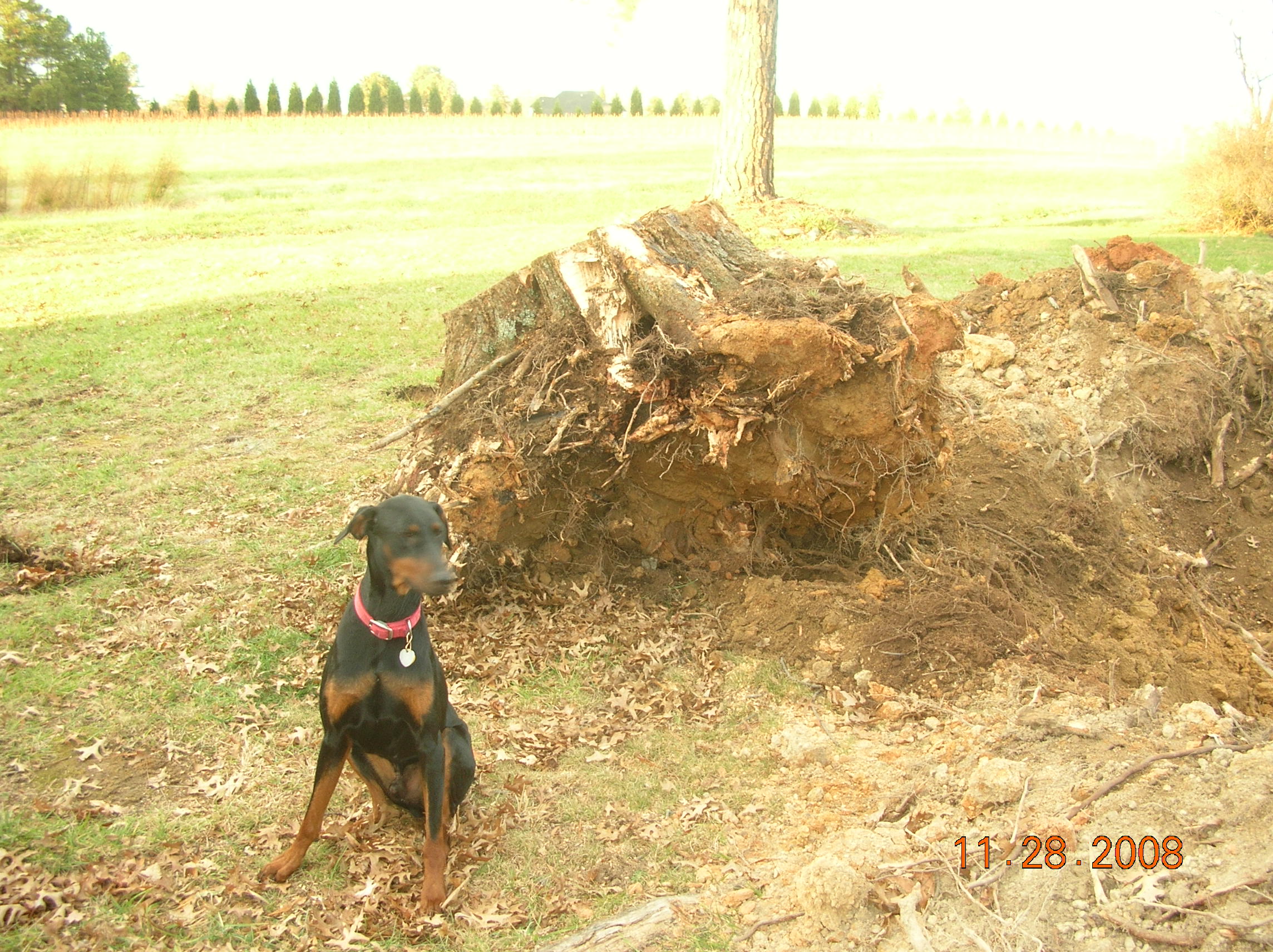

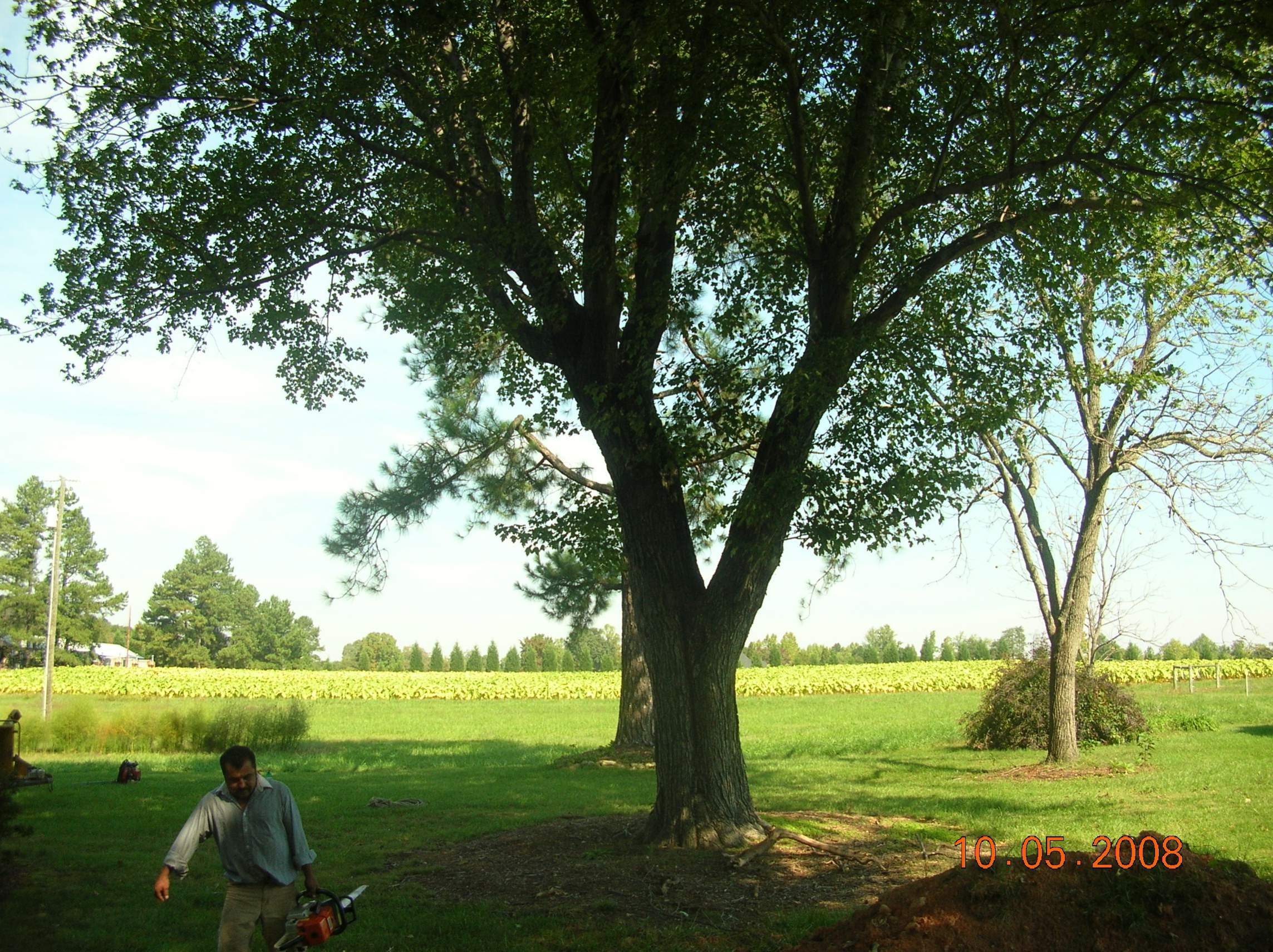

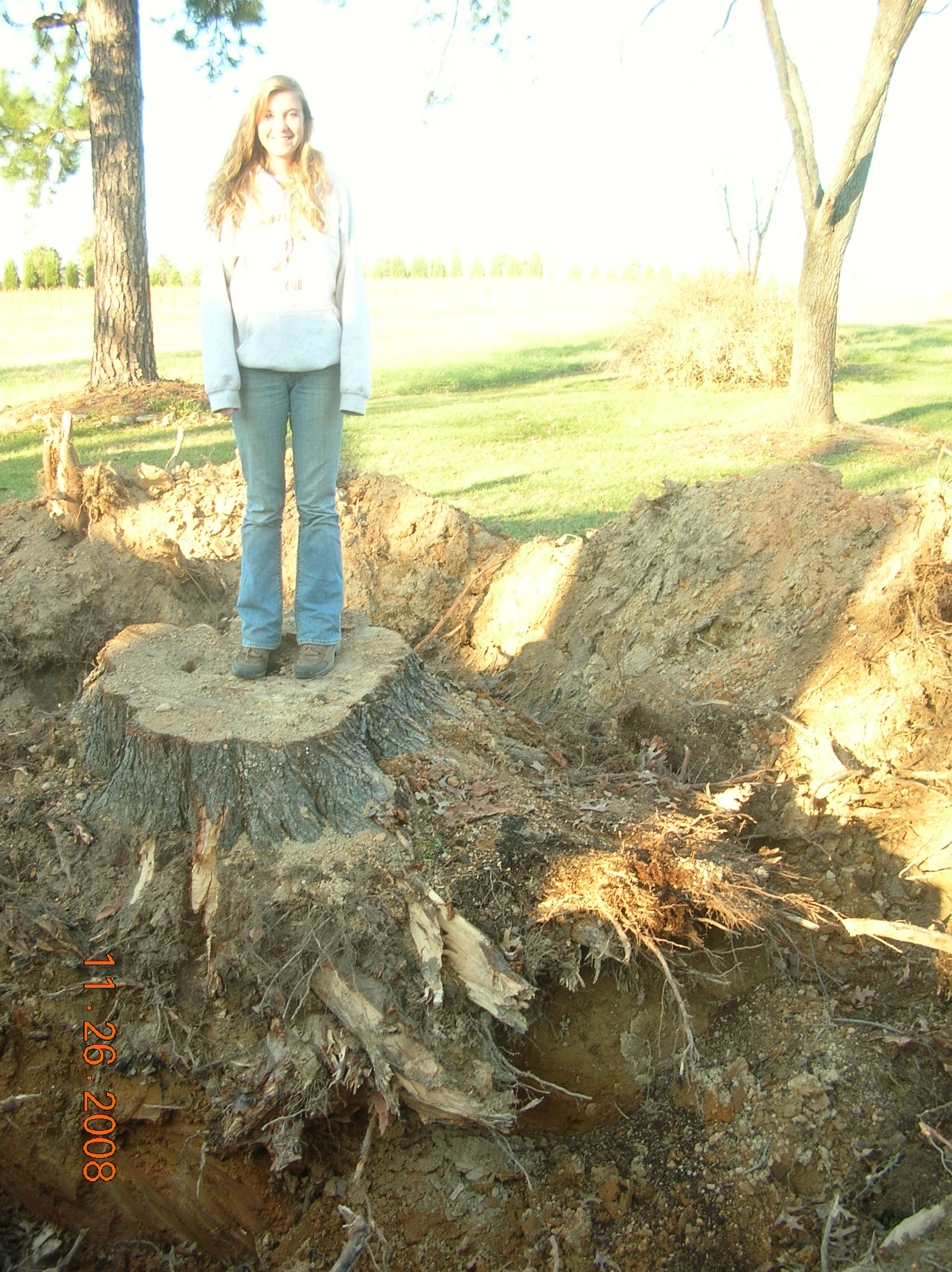

You won't pull it. Maples have a prodigious root system. The hoe will dig it out, by cutting the roots. Then, you'll be able to extract the root ball.
Here's a silver maple 28 inches at the base.
