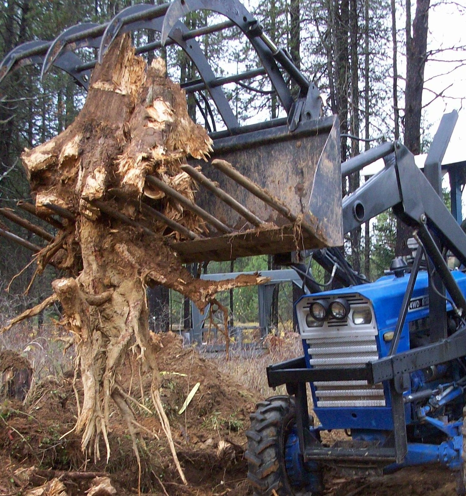

I would just go slow (take your time) if you dig around it with the hoe then if the roots are big you may have to do what I did with this one- clean, around the really large roots and then chainsaw ,or saws all them stump large- 005.JPG these stumps can be very deceptive when you can't see the bottom, it took about 4 hours total to get out.
Also it makes a big difference in removal difficulty how old the stump is (how long it's been dead) the 1st one was only cut the previous year... This stumpRHINO stumps 004.jpg had been dead 3 years and I grappled it out in one scoop! It had also been raining for 3 days. The trees were less than 30 feet from each other... Go figure?.? Any way, best of luck I'm sure you will get her out.
