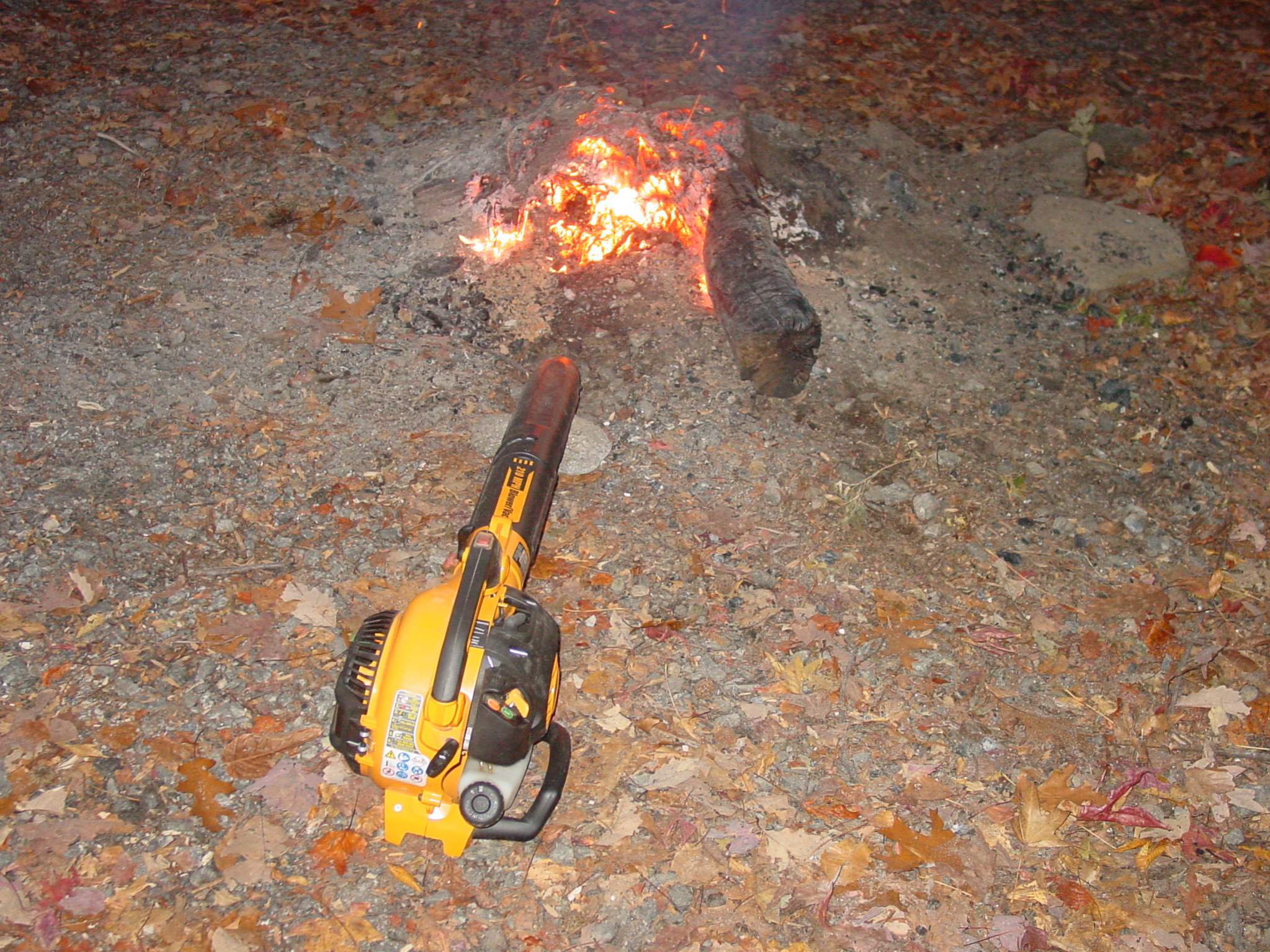

Tractor Supply and some other places still carry the potassium nitrate stump remover. I've not found it to work all that well. I battled a large walnut stump for a few years before I finally burned it out by directing a leaf blower on it while lit with a small campfire on top of it. It would never stay burning without forced air even after several pounds of stump remover were put all through it in 1" diameter up to 12" deep drilled holes over a period of a year or so.....
