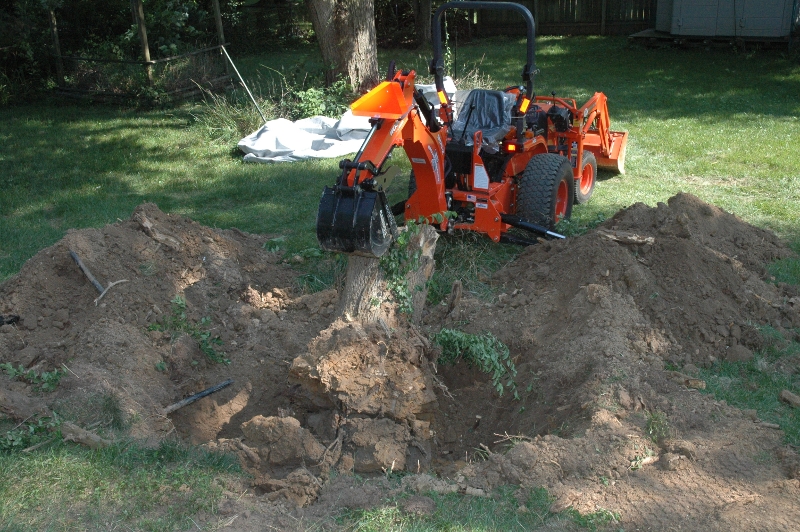

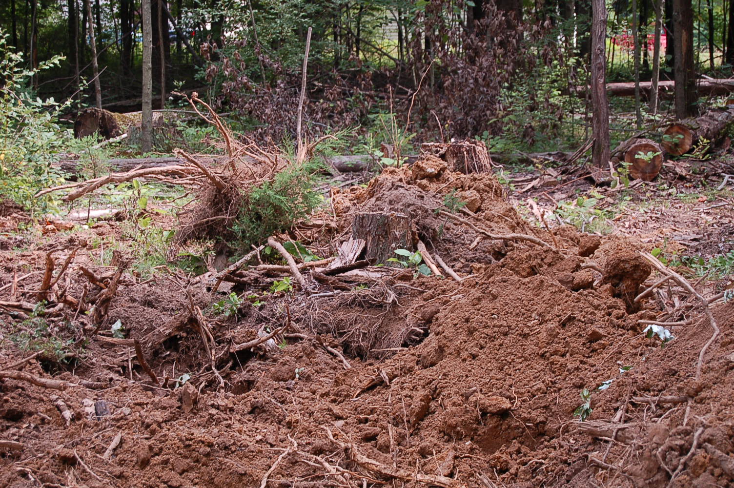

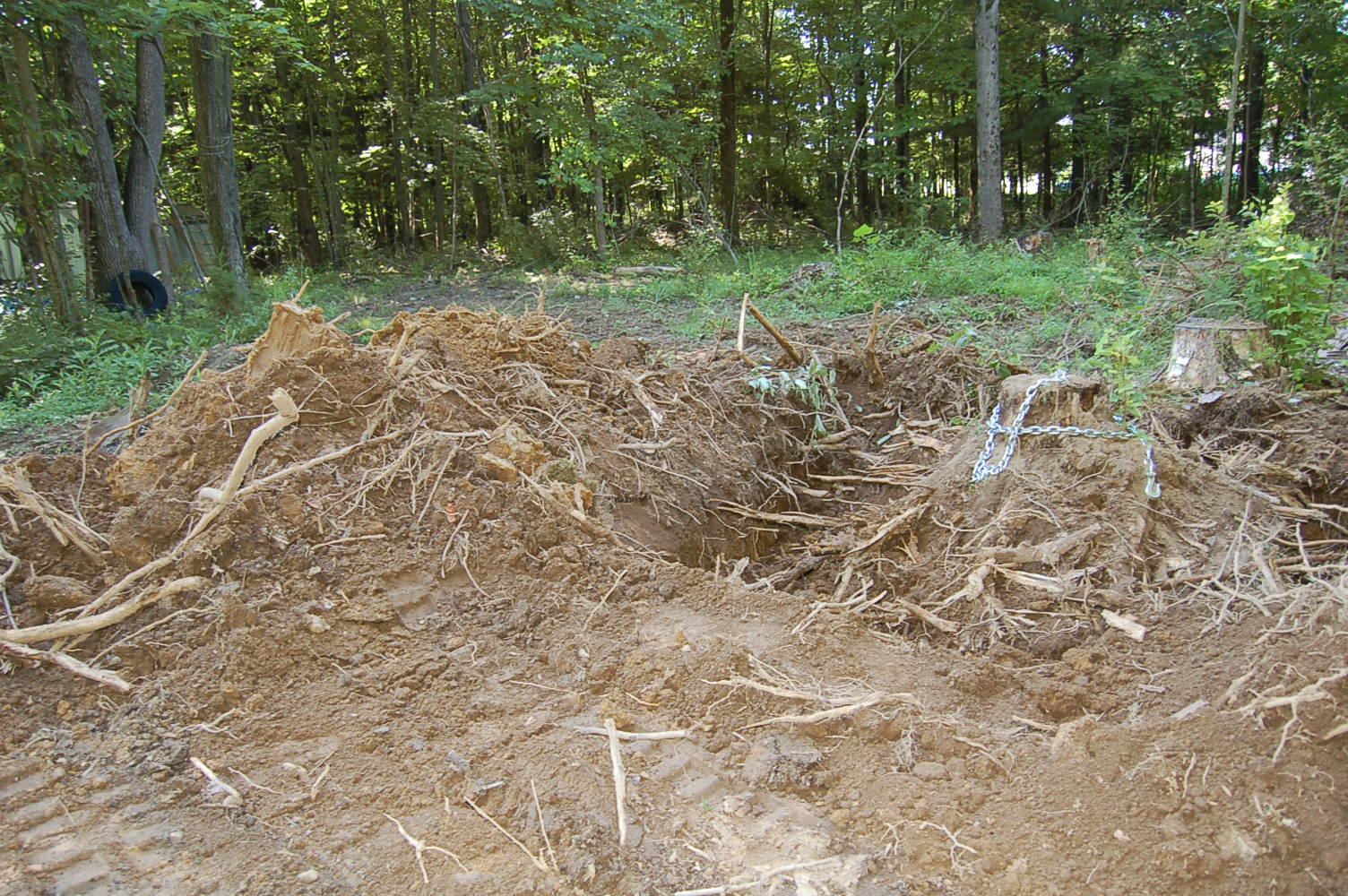

I'll post photos later today, but right now I'll try and describe my problem. I rented a 3ton excavator to remove some stumps. Took awhile to learn just how to operate the thing. I've always admired people who make it look easy, and now it has grown. Maybe I'm just challenged. :eek:
I have one stump "dug". This means I have a trench dug around the stump, probably about 12' in diameter. Now how do I get the root ball removed. I dug the trench too far from the stump to get a good grip with the FEL. I'm trying to avoid digging an access ramp to break the stump loose from the ground. Anyone have any suggestions on how to break the stump from the ground? I haven't hooked a chain up to see if I can just pull it loose. But for some reason I just think that's going to work.

Based on the photo I'd say you need to dig deeper.
For stump removal I rented a 12 ton machine and it was just enough. One thing to remember, at least on the oaks and other hardwood I deal with the center root stem goes way down, I've had to dig about 5 foot deep to get near the bottom, then with excavator, I peel it out using the stump to grab onto.
One thing with stumps, other than pines, which don't count, you've got to dig a lot deeper than you'd expect.
I"ve got a post on the subject.
http://www.tractorbynet.com/forums/kioti-owning-operating/141898-stump-little-too-big-kioti.html
In the end I think you need to dig deeper. Otherwise like trying to pull a carrot out of the ground straight up, near impossible on a stump.

Well after a few more hours, I managed to get it to wiggle with the excavator. I went back and dug about a 1' deeper. After lunch I think I'll try the tractor again. I started on a second stump and this one I'm trying to dig as close to the stump as possible. It's taken me awhile to learn how to tear through roots. You can get through some pretty big roots if you peel a little at time off. Good thing I've got the excavator for a week.

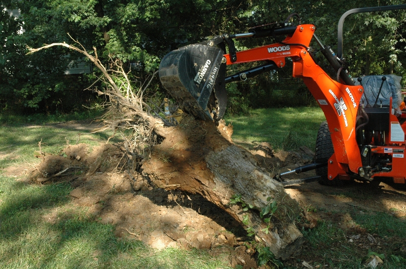

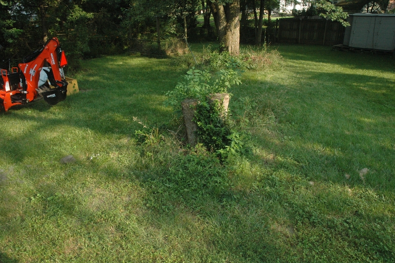

Success.
First Photo is where I was at this morning. Notice the second stump in the background to the right. I managed to get that stump out first and it was bigger. Second and third photos are of the problem child.. I had a heck of time getting it out of the hole once I broke it loose. I learned from the second stump that you kind have to feel your way around and stay as close to the stump as possible. The second root ball was much smaller and easier to handle. Last photo is of the hole from the two stumps and it shows the next victim.
Thanks for the pointers

Looks like you did a great job. At least they're out of the holes.. :)

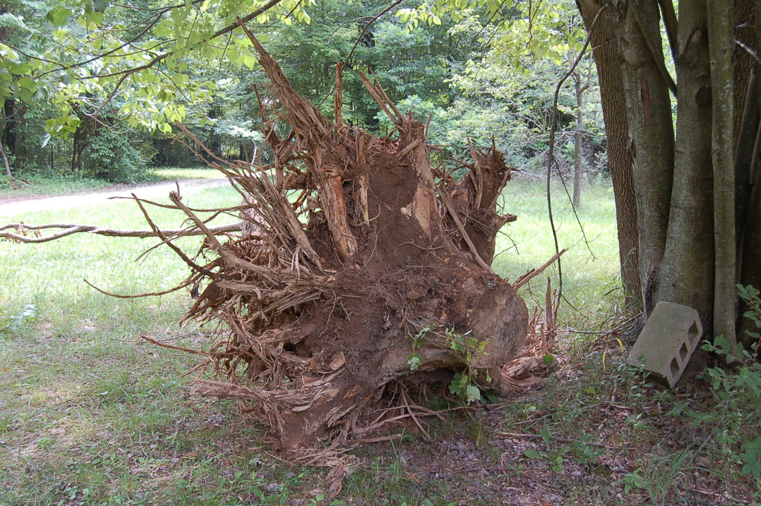

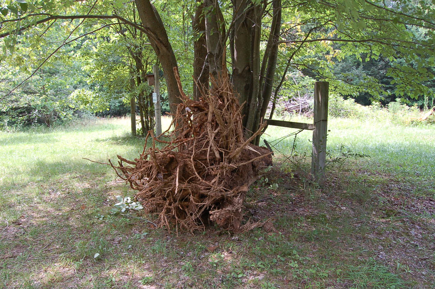

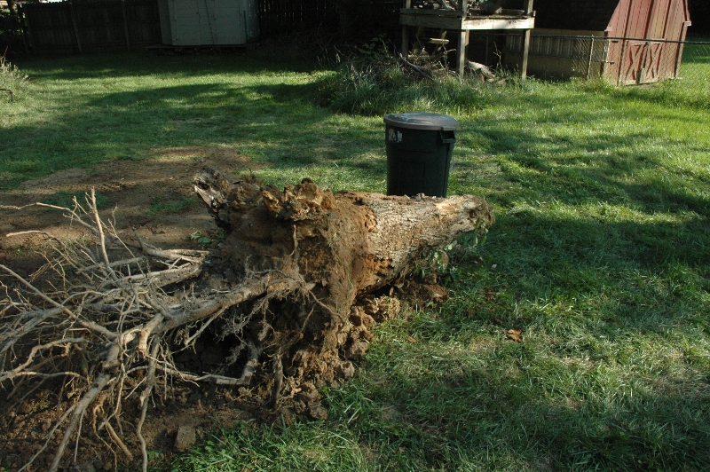

Haven't you guys heard. Size does not matter, it's how you use it. I have a little MF2310 and have become quite skilled at removing stumps and ones far larger than the one in your photo. First is digging deep, at least 4'. I typically go to 5' if it is 12" or larger. This enables you to loosen the tap root. Other trick is to tear the roots with the bucket in small bites. I typically point the tooth of the bucket down on top of the root, press down to put as much weight on the root and then curl the bucket and it tears the root. In addition, keep your stumps long if you can. This helps with leverage when trying to pop that tap root out.
Depends very much on type of tree and ground. My oaks have root taps that go much deeper than the stump you got the picture of, including the stump. I've dug 5 foot and not even gotten to the base of the stump where the tap begins, much less being able to break the tap. Took a 25000lb machine to have the power to lift the stump out of the hole once freed. There was no way my 7.5 foot hoe could've gotten to the tap much less break the tap, I've not hit roots I haven't been able to adventually break, but the tap is another story all together.
Also, after 3-4 hours of continuous digging with little progress, was much easier to get the larger machine and do what I couldn't have done period with my machine, done in 10 minutes.
As I've said in the past, I don't think there is anything tougher to work with than hardwood stumps.

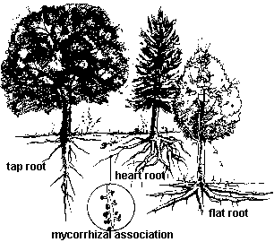

If you've got a true tap root I THINK the best thing would to dig as deep as your BH could go, angle in and call in Stihl.
I was just about ready to do that until with a lot of wiggling I broke off my little one.
