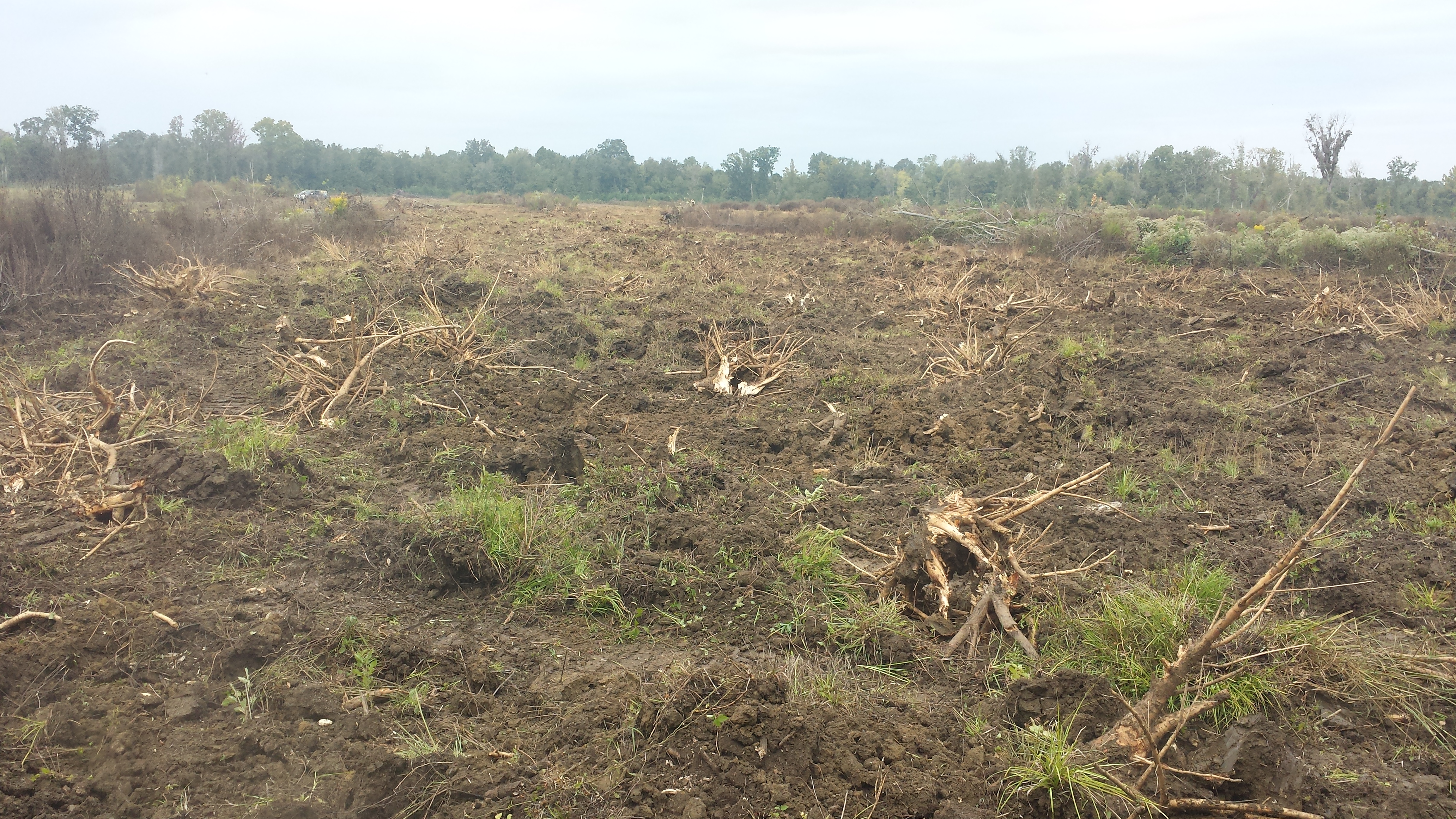

   / stump removal #28
Excavator
   / stump removal #29
A D9 prevents stumps left in the ground. :)
