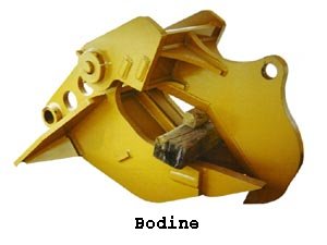

   / Stump splitter on a backhoe?
The main advantage of stump splitter is that it splits the stump into pieces while still in the ground which makes it easier to remove and then grind or burn. You can also apply more pressure to a stump with a 2" thick splitter compared to a 12''-18" bucket.
Digging them out can take longer and then you have one solid stump to deal with, plus it can put more wear and tear on your bucket and boom.
I found another stump splitter on the market but this one requires extra hydraulics, man what a mean looking piece of metal (see attchment) /w3tcompact/icons/smile.gif

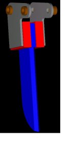

   / Stump splitter on a backhoe? #7
I built one for my bx22 but have not had much time to test it out with the ground being so frozen here in the northeast. have to wait till spring. its made from 1" steel plate 20" long by 4" put a knife edge on it and hard faced it with weld. attached is a drawing I drew as a design.
