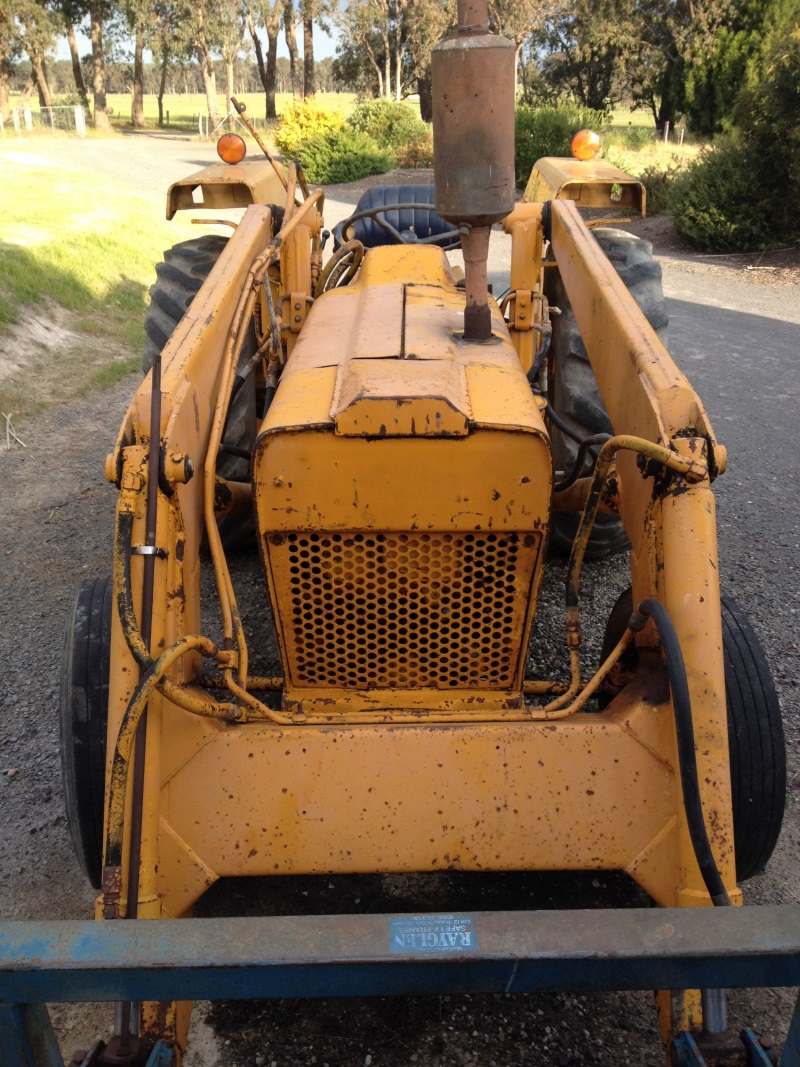

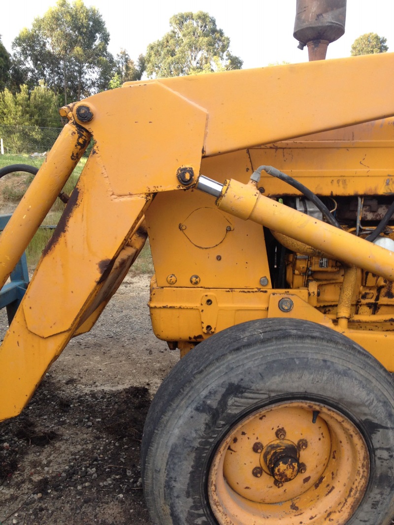

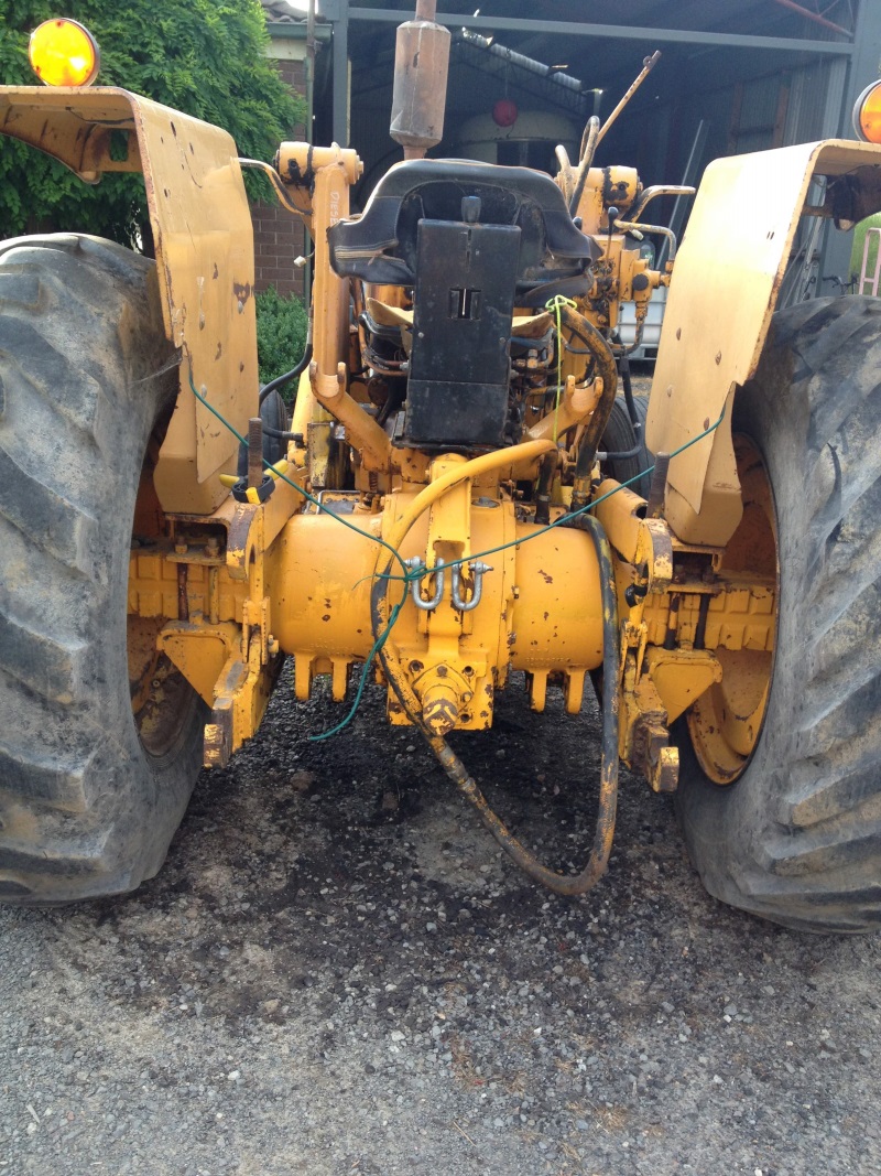

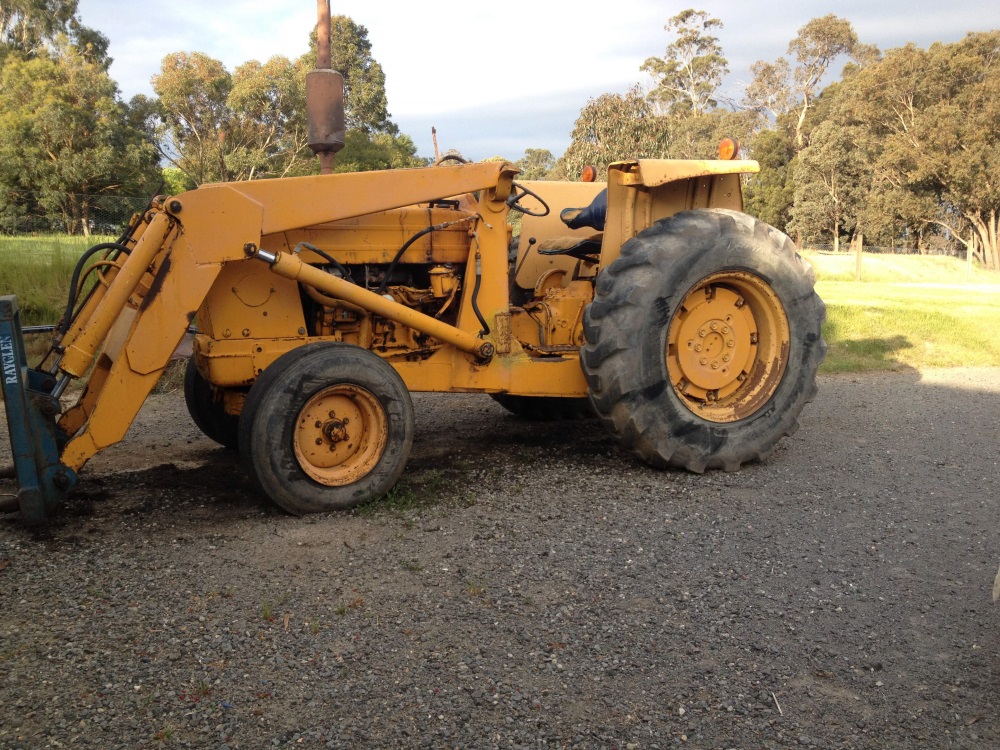

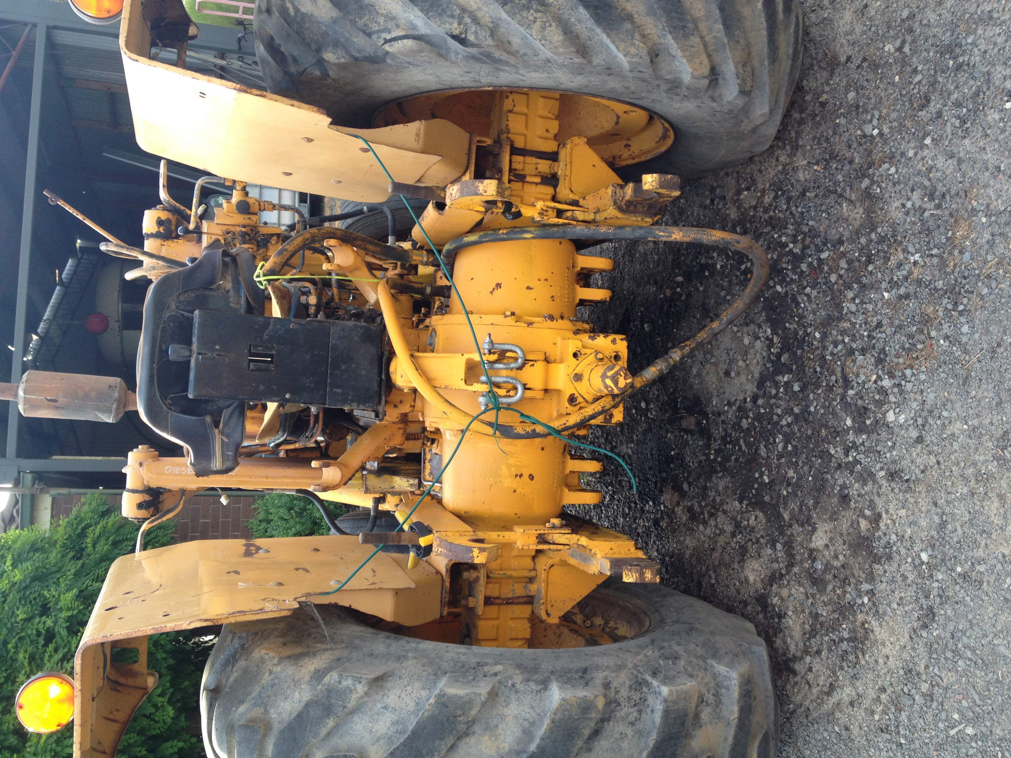

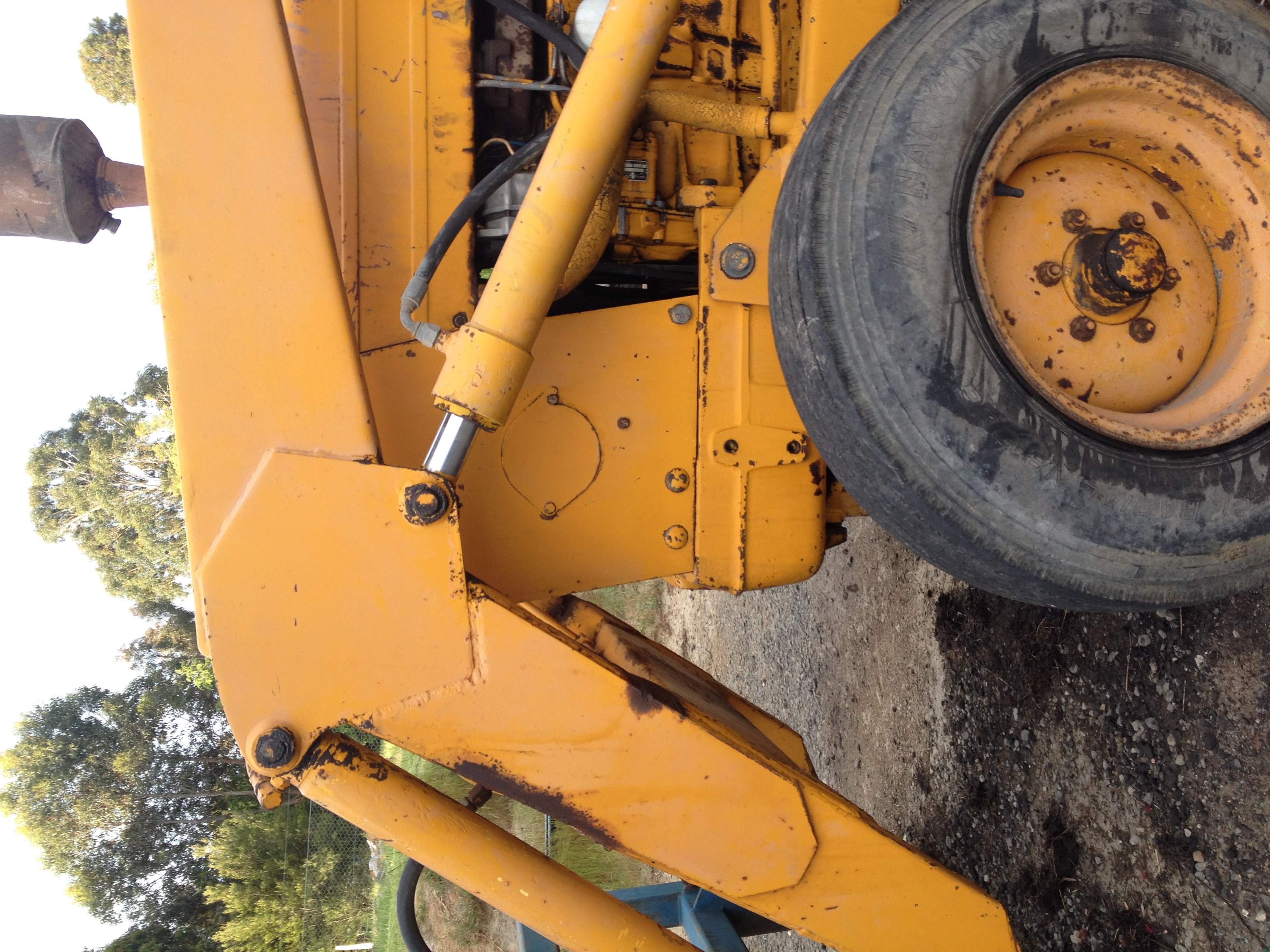

Thanks for the welcome guys. I've had a look through most of the attached links previously but still struck out. I've got a feeling it might be a 340 Industrial but hoping to get it confirmed.
Here's a few pics of the ol girl.
   / Stumped #7
Let me see if I can make them viewable (resized smaller and rotated).
   / Stumped #9
I'd guess it's a 4500. It's been a looonnnggggg time since I've seen one, but that's what it looks like to me.
   / Stumped
That's was my thought too, but the C at the start of the serial number denotes a 3000 series from what I've found...........but the swept back front axle and the access cover to the air cleaner indicates a 4500. :confused3:
