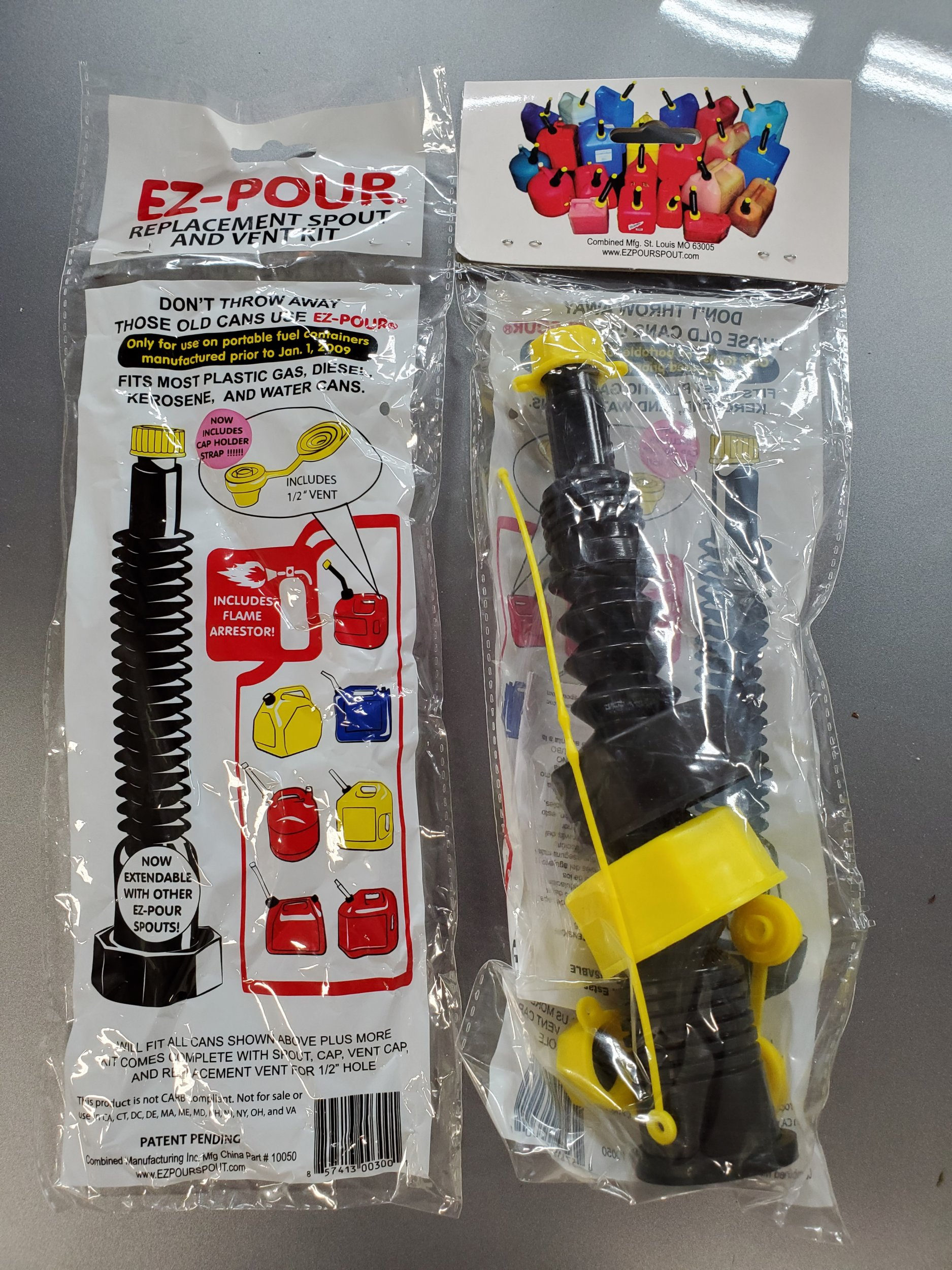

I replaced all the PITA spouts on all my gas and diesel cans with spouts from Rural King. They have lasted 8-10 years so far. Ez-Spout comes in two sizes. Smaller nozzle diameter for gas and larger dia for diesel. I bought them when they were $6 each but now are $9
As far as using silicone cooking sheets. That silicone will stand up to any solvent, including gasoline, kerosene, diesel, etc that I would expect you have in your garage. My only concern is the cooking sheet is too thin to make a proper gasket that has enough thickness and is correct softness ( durometer ) to fill in the irregularities between spout and can opening so you get a good seal.
