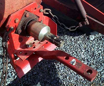

This is what I think of when I think drawbar.

Thats what I was thinking of.

remember, if you get one of those lift arm 'drawbars' to be careful about what and how you pull. When you pull from the hitch arms you can make it very easy to roll the tractor over backwards. I admit, they are nice when quickly moving trailers around, but if actually working, your better off using the 'tractor drawbar'.
