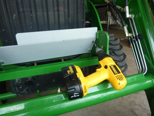

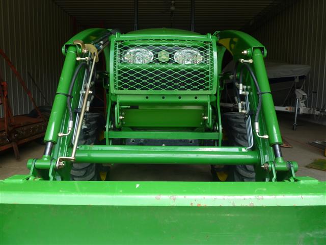

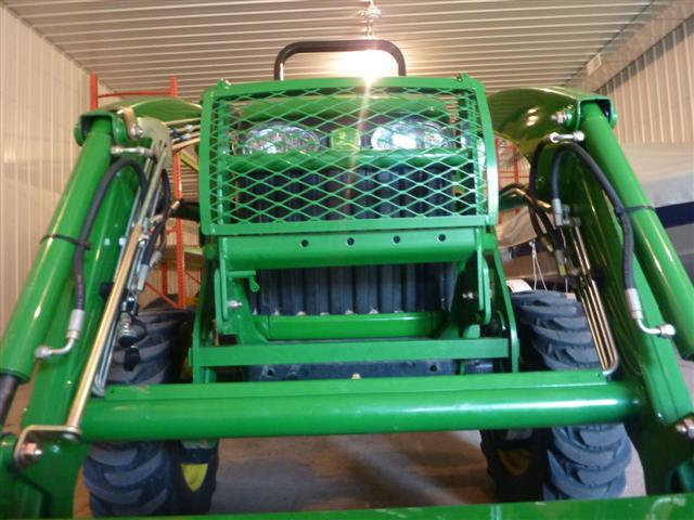

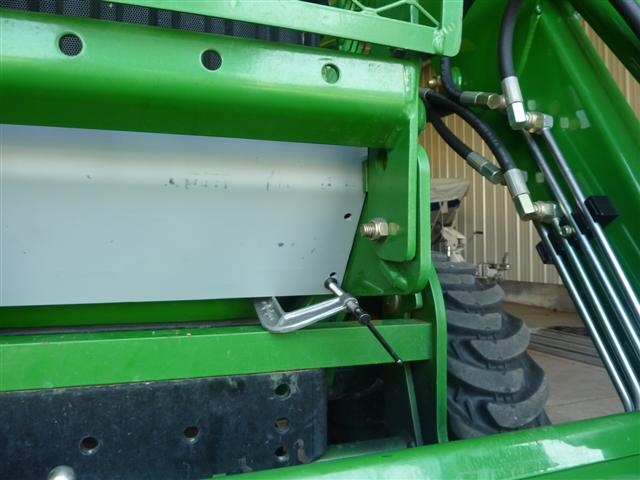

On my 3320....the grille guard Deere offers is only half a guard IMO. I made a plate to protect my radiator. Simple / effective. IMO Completes the job Deere shudda done.
The clearance is much improved with the 3320....so I don't get other damage now that my grill is protected. :thumbsup:

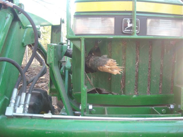

Timber is ruff on tractors. Protect 'em! In my post above I added to the JD guard on my current JD 3320. I don't understand why they protect two thirds of your grille and not the rest. If I can easily make a good gaurd to take care of the deficiency I cannot see why the JD engineer's cannot do so too. :D (see above)
Here is why I am adamant about protecting my grille. I upgraded this grille guard on my old JD 790 after this event. If you operate in timber....you have been warned! ;)

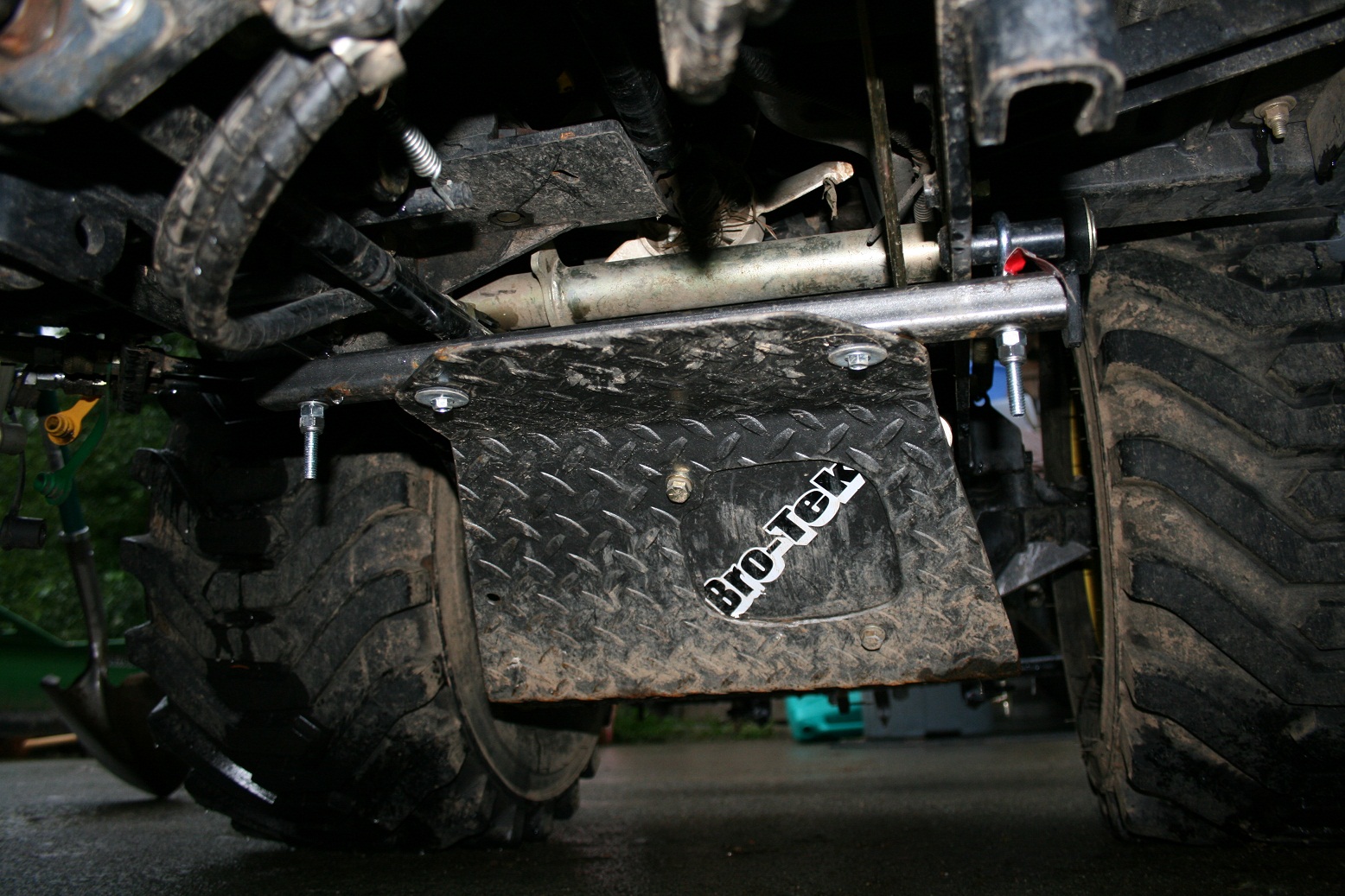

Sorry for the late response, but it looks like bp fick identified the part for the 2305 in post #12. I believe its' the same armor, but with different mounting provisions. Keep in mind that the BroTek has to be removed to use a Mid Mount Mower (I don't have one).
