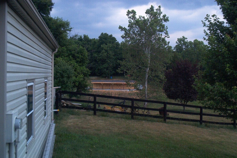

I read these threads in the "Attachments" section about running poly pipe behind a subsoiler. My question is for the northern climates is this a good idea or can it be done? Some of the threads I have read, the poster is in somewhat of a southern climate.
Here's the deal:
I finished up a horse barn about 100 yards from the house the other week, and the wife wants a Frost Free hose bib installed at the barn for water. Also wants a few other bibs around the property. Anyway, in Northern VA, frost line is 3', so I'm assuming that I'd have to get a BH come in and dig a trench from point A (house) to point B (barn) 3' in depth and then lay the pipe. Make the connections at the two ends and then backfill the trench. My concern is so that the pipe doesn't crack in winter, the point of putting it 3' down into the earth.
However can I get a sub soiler and trench the pipe for this, knowing all along that depth probably won't get close to 3'. Do you shut off the water lines during the cold months of the year to the outside pasture bibs, if you don't go to a depth of 3'. Similar to your outside house hose bibs in the winter months? What have some of you guys done or have some suggestions?
Thanks
sean
