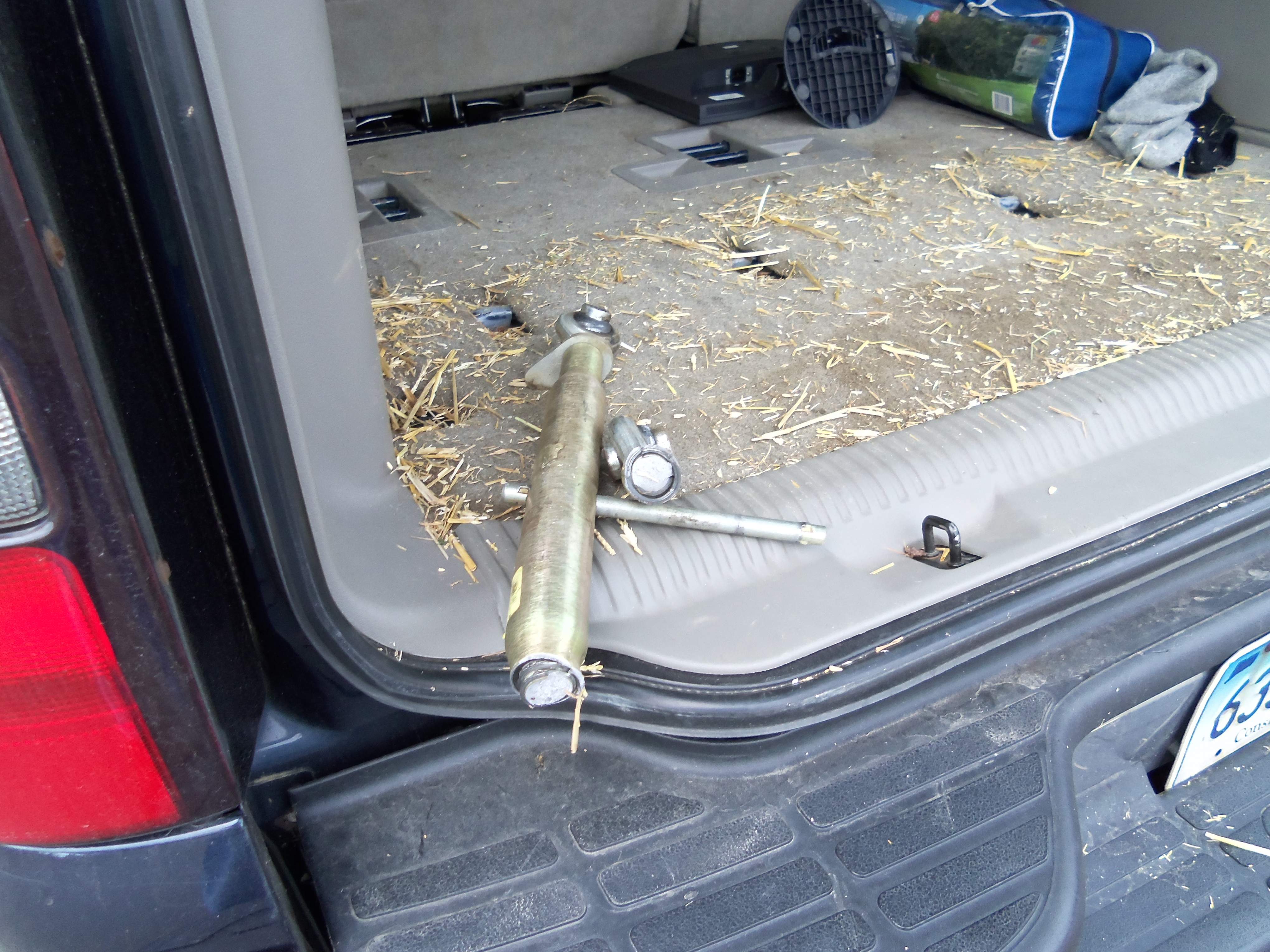

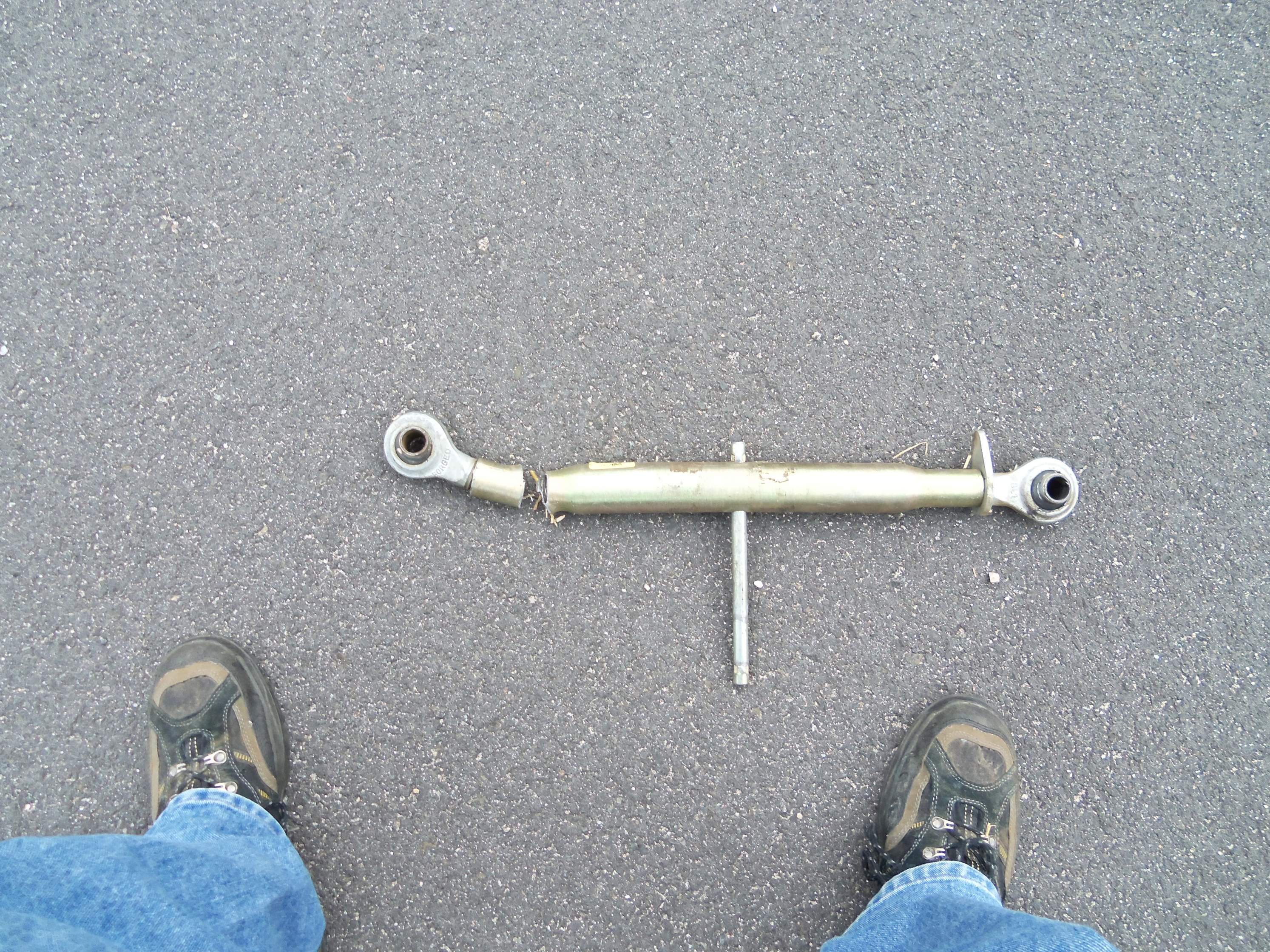

I broke the top link while using a subsoiler with my Kioti DK40SEH HST I guess I did something wrong with the 2nd lever that adjusts the float for the 3 pt hitch any suggestions as to what I did wrong and what I should do to avoid this again, I imagine I could have done more damage then I did.
   / sub soiler broke top link #2
Derek, please explain how the toplink broke. Did it just snap off or did it bend into a banana shape? When you are digging with a subsoiler, the pressure on the toplink is all compression. I'm inclined to say you had a faulty toplink, but a photo or more details might help us to better evaluate your failure.

I will bring the top link to the shop tomorrow (forgot to bring camera home) thats all that left to take photo of it is slightly bent it broke both the female and male parts of the top link. I really do not under stand the float lever for the 3 pt hitch. The subsoiler was very deep and if I remember right it was angled with the top tilted toward the tractor I think it pulled down too deep? Still the top should not have busted right. I thought the top link was maybe faulty (even though I have been using it for 2 years) until I broke the second one. I wish I had taken photo of the whole thing busted in place.

I used the top hole, if you look closely at the break you will see that it was bent slightly. I understand that the 2 lower holes are for the draft but it seems that every time I adjust the yellow lever the hitch either will not go up high enough or down low enough especially when I am using rear lever for the 3 pt hitch.

If it was bent before it broke I am sure that contributed to the breakage.
Did you hook on to a root or a rock.?? How fast were you going.??
A sub-soiler definitely puts a lot of stress on the top link, as you are now aware, I'm sure.:D

I was in low range going very slow I think sub soiler hooked in under a root.
   / sub soiler broke top link #12
My two cents worth. The subsoiler does not have a shear pin and the top link acted as one. If the top link had not broken the mounting point for the top link on the tractor would have been pushed in making for a very expensive repair. I have often wondered when looking at subsoilers without a shear pin or tripping mechanism offered at some retail locations how much damage would occur if a solid object was encountered. I would be thankful the toplink is what broke and explore other options on how to insure when the subsoiler encounters a solid object under ground it trips and does not break the tractor housing.

I have one of the TSC variety and have hooked onto something big a few times and only lost traction as a result. Once so abruptly that I thought I was going to go over the hood. Shear bolt of some sort would be prudent, and not terribly difficult to add. Since the top link is in compression, any off axis load will tend to buckle it - a slight bend would do it, as would excessive slop in the threads. When using mine, I try to adjust the hitch so the big beam/mast is as close to vertical as I can get it when it's at working depth.

Derek, from the looks of your toplink break, I think it was being bent and compressed at the same time. I've attached an illustration of what I think may be the culprit.
When you are shallow with the subsoiler, the compression pressure is straight along the axis of the toplink. As the subsoiler goes deeper into the ground, the pressure becomes not only compression, but a bending force as well. I think your toplink is just not strong enough to take the bending force caused by your subsoiler, especially if you hit a root and it got an impact load.

I don't see how a "bending" would occur as there is no moment connection if the clevis does not bottom out. The force will continue to be exerted straight along the toplink. However, the amount of force on the toplink would increase due to the change in relationship of the length of the "lever" below the 3 point connection and the diminished length above.
Exactly right - well put.
Since there's a "pinned joint", the top link is in pure compression, no bending load applied. Any looseness of the thread could allow a kink or curve in the toplink and add a bending load - so always tighten up the adjusting nut when running ground engaging implements. If the top link dead straight and rigid, then the risk to top link is only buckling due to compressive overload.
Angle above 90 degrees (call it A) between subsoiler & top link magnifies the compressive load - same principle that makes a chain binder work so well.
Compressive load in the top link = Load at the pin * (1/cos A).
I think the OP mentioned that the top link was already slightly bent before pulling the subsoiler, so the combination of bent link + binder effect of the angle was probably much. I don't think there's anything wrong with the subsoiler.
