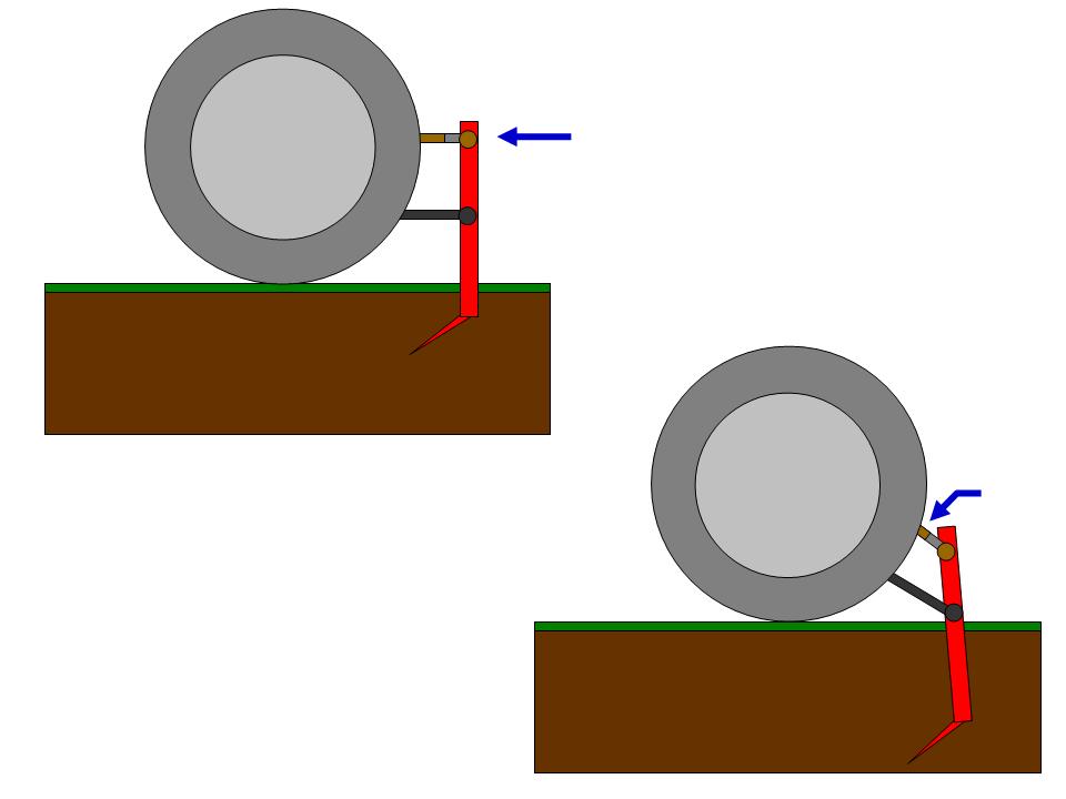

Derek, from the looks of your toplink break, I think it was being bent and compressed at the same time. I've attached an illustration of what I think may be the culprit.
When you are shallow with the subsoiler, the compression pressure is straight along the axis of the toplink. As the subsoiler goes deeper into the ground, the pressure becomes not only compression, but a bending force as well. I think your toplink is just not strong enough to take the bending force caused by your subsoiler, especially if you hit a root and it got an impact load.

My son in law did this same thing earlier this year. He borrowed a subsoiler from another farm and used it with a 47 HP Challenger MT285B (same as MF 1547). The geometry of the three point hitch allowed the top link to go over center when lowered way down. The force allowed the subsoiler and the top link to be too straight and the angle between the subsoiler and the top link went from a V to an inverted V. When the 3 PTH was raised all **** broke loose. The solution was to change the hole on the tractor where the top link is attached so that it always is parallel to the lower lift arms.

I don't see how a "bending" would occur as there is no moment connection if the clevis does not bottom out. The force will continue to be exerted straight along the toplink. However, the amount of force on the toplink would increase due to the change in relationship of the length of the "lever" below the 3 point connection and the diminished length above.
Exactly right - well put.
Since there's a "pinned joint", the top link is in pure compression, no bending load applied. Any looseness of the thread could allow a kink or curve in the toplink and add a bending load - so always tighten up the adjusting nut when running ground engaging implements. If the top link dead straight and rigid, then the risk to top link is only buckling due to compressive overload.
Angle above 90 degrees (call it A) between subsoiler & top link magnifies the compressive load - same principle that makes a chain binder work so well.
Compressive load in the top link = Load at the pin * (1/cos A).
I think the OP mentioned that the top link was already slightly bent before pulling the subsoiler, so the combination of bent link + binder effect of the angle was probably much. I don't think there's anything wrong with the subsoiler.
