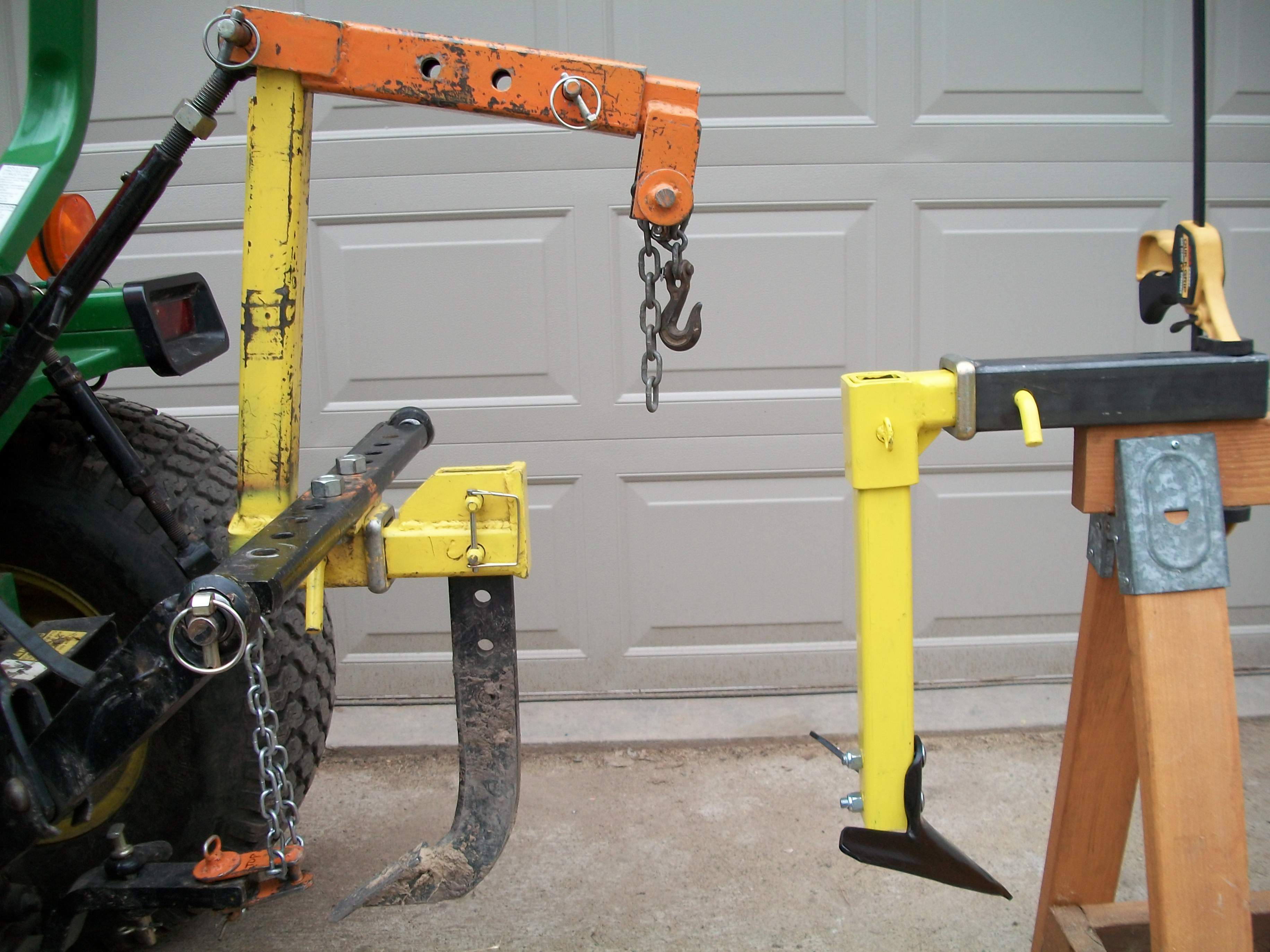

Back in the late 80"s I bought a Middlebuster from a large, national tractor company that has since gone out of business. The cross angle that goes from side to side at the lift pins twisted after very little use. I had the angle straightened and another piece of 3/8" angle welded in. That made a box section. Now that baby will pull China up to the surface.

I did basicly the same thing to the one I bought several years ago and it works great. How many inches deep will your's dig ? I haven't measured the depth that mind will go but I would estimate 14-16 inches deep. I have buried over 1300 feet of water line with it and broken many garden spots over the years before I tilled the ground. If I could figure out how to get a picture pasted to this note I would send you a picture of it. When I use it as a sub-soiler I checkboard the ground and them use my tiller to get it ready for my Covington Planter.

I agree it is better to strengthen the TSC subsoiler before using it as straight metal is easier to work with. I think it is a matter of when it will bend more than IF. I plan on fixing mine before I use it again, been lucky so far.

Mine hasn't broke yet. But the 2 carriage bolts that held the shoe on gave way an lost shoe. Went to get another shoe an they don't stock them. Poor made equipment in my book. Will make my own with AR plate.
