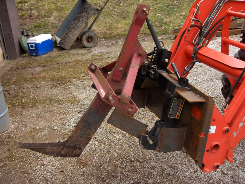

I can also turn the SS around and use it the other direction and pull it backwards as well. I built my adapter a little beefier out of concern that I might twist the Torque tube on the FEL and I wanted the adapter to not flex.
In my testing I initially saw flexing on the outer edges at the top and I added a square plate to the top on the outside edge of the plate and Quick hitch. I would rather bend/brake an implement than the FEL. I also have a shear pin on the SS in case the pull or push is to much.

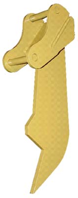

Here is one already cut and ready to be mounted. Monster claw.. 22 in, 3/4 in thick

Looking at that yellow claw, it looks like it would work better if the front edge was angled or sharpened. My subsoiler has an angled front edge which allows it to slide thru the ground and cut roots better, (and if you're not watching...phone lines, pvc pipe too).

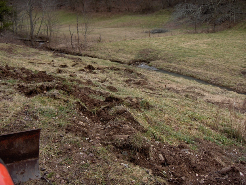

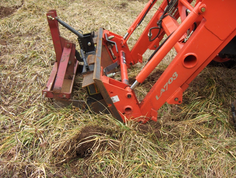

I got a little seat time on the tractor today and I thought I would test the sub soiler a bit. It looks like a giant mole has been busy here. The tractor will run out of traction if you sink it to deep but it meets the intended purpose.
Yea I know I could have done it with the Sub Soiler on the back but then it wouldn't have been much of a test. I intend on using it mainly for grubbing around tree roots and the like. It works best by driving forward and sinking it in the ground and then using the curl of the bucket to break it out.

I agree that you shouldn't get real aggressive but if you think about it you stick your bucket into a pile and rollback with the full Hyd force and sometimes it will not break it out. I go fairly slow and the tractor will loose traction before anything starts stressing. I will not ram it in the ground just like I would do my bucket that way. For sure the SS does better on the back (and it will still fit on back) but some times it can be handy this way. Like grubbing roots stick it in the ground and roll back the stress is on the SS and not so much on the FEL or tractor ar not a lot more than the Bucket would be.
