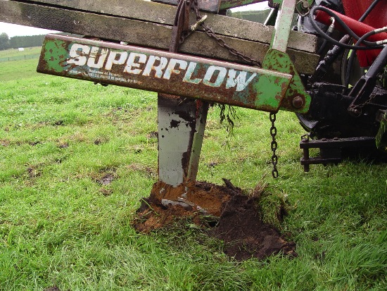

The L4400 has 45HP. Mine has 4WD and HST. I need about 16 -18 inches. What'ya think?
Jon

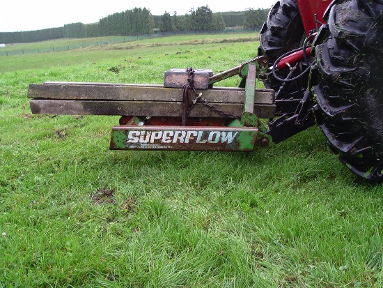

I've got a single leg ripper that goes to about 18" and I pull that with a 65 HP Case-IH 3230 4WD and it has it's work cut out. It's got a reasonably large foot and leaves a hole that I can put half a forearm into. Maybe 3.5" diameter. I have to add ballast to the ripper frame to get it down to full depth. After 2-3 hours, the hydraulics get too hot to be able to lift it out again, so there's a good amount of work being done, ripping at that depth.

Years ago dad decided that we needed to sub soil our fields. It was unbelievable to me how much power it took to drag 3 shanks about 24" deep. It did seem to help some with crop yield. It also helped with drainage. I think that things did best where we could go deep. We were always fixing,welding, and adding more weight. I would only go with 1 shank and make it strong.

You're marginal on power for ripping that deep. 45 hp is your engine hp. Your drawbar hp is probably more like 35 hp.
My neighbor uses a MF294 tractor (74 hp engine, 54 hp drawbar) and a single shank parabolic ripper to break up the hardpan down to 20-24 inches. That ripper is a real load on that 294.

Yeah I see what you mean. And that pasture is green. Where I'm planning to work is dry and brown clay. I think smaller/less aggressive is better in this Case :rolleyes: (pun intended).

Works for me. I'm thinking 18" deep is enough. Does that make sense?
Maybe 1" thick CRS. Cut my parabola shape with my torch, drill a shear bolt hole. I have a tool bar that will accept the shank so I wasn't thinking a 3pt hitch configuration. Rather fashion a receiver that'll affix to the TB. Let it shear at that point. Any insights?

I believe that a ripper would pull much easier if made in the form of a drawbar attachment. Part of my reasoning can be explained by thinking about the way a disk pulls. 3-point disks pull hard compared to wheel (drawbar pulled) disks. The drawbar implement is more free to seek the path of less resistance compared to the 3-pt restricted motion. Also, the drawbar is completly indestructable. I can pull as hard with the drawbar as I want to and I cannot hurt the tractor (unless i overheat the transmission). I am not that sure of the three-point parts.
It's a little bit more work to put cylinder-lifted wheels on it, and a little bit more metal for the backbone and hitch, but these costs should pay back with more efficient operation.
