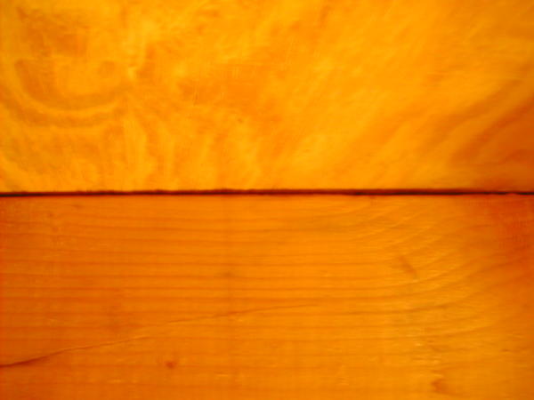

5030tinkerer said:
What sort of trouble did you have with it? In what application? Until your post, I hadn't heard of anyone anywhere that had trouble with it.
I used Liquid Nail to glue my subfloor to the joists, and then nailed. It has popped loose in several areas. In a couple places I can see in the basement where there is no ceiling, the nails in those places missed the joist, but other places it popped where the nails have not missed. Still I would have expected the glue to hold. I have 2x10 joists, which are not as true, so that contributes to the popping. Here's a pic of one area, hard to tell from the pic but it appears the glue has seperated, and not the wood has pulled off one side.
For my garage I used TJI joists, and it's glued with FS110, supplied by the company I got the TJI's from. I have not found a problem with it so far. It says it will bond wet/frozen wood.
