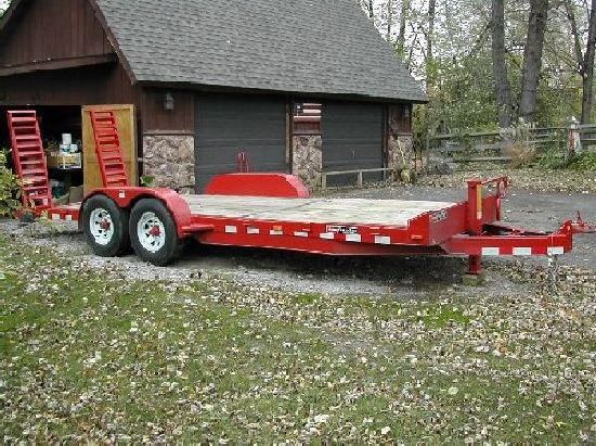

LB; I prefer the ramps over the tilt simply because I sometimes haul more than just the tractor with FEL&Boxblade. The additional stuff is tied down on the front and I think the weight on the front wouldn't let the bed tilt. Also I've noticed quite a few ramp trailers have the ramps secured such that they are at a forward angle. To me, that seems to limit again the length of stuff you can carry. One of the drawbacks with ramps and a beavertail is that the tail is quite low. I've scrapped the bottom a few times going in and out of alleys and parking lots. /forums/images/graemlins/frown.gif Ofcourse the noise always make people look if your into that. /forums/images/graemlins/smirk.gif

   / Subject :TIlt or Ramps #17
<font color="blue"> I sometimes haul more than just the tractor with FEL&Boxblade. The additional stuff is tied down on the front and I think the weight on the front wouldn't let the bed tilt. </font>
The one tilt trailer that I think I may end up buying next year (C & H? Info downstairs...) uses either a hand-pumped or electric-pump driven hydraulic cylinder to lift the front up when tilting. I don't think having something on the front that was heavy would be an issue, at least within limits.
Myself, when I buy it will almost certainly be a tilt trailer...
   / Subject :TIlt or Ramps #18
Bill; With a setup like your talking about, weight up in front probably wouldn't be a problem. Sounds like a setup someone sat down and thought about. I think most tilt beds are victims of mean old Mr. Gravity though, so weight on the front could be a problem depending on where the pivot point might be. /forums/images/graemlins/grin.gif
   / Subject :TIlt or Ramps #20
LB; Most times I use the loader to lift whatever I need on the front. If you drive up the back of the trailer with a load chained to the loader, you windup having to raise the loader too high to be safe. /forums/images/graemlins/grin.gif
