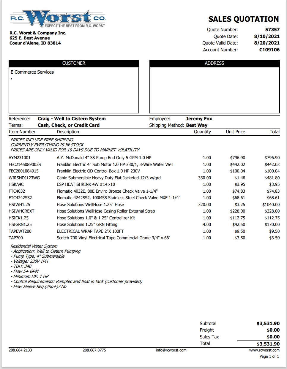

I'll be replacing mine, hopefully when the weather gets a bit better. Currently the pump motor is pulling 10 amps so seems something is going wrong after 25 years. Here is what i'll put back in. Unfortunately, pretty sure it's be more expensive.
   / Submersible well pump recs please #30
So, how deep is your well? The pump is designed for 280 to 620-ft set depth.
