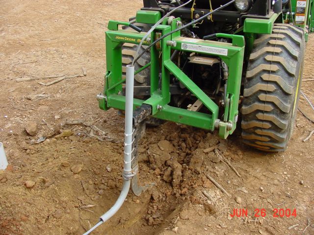

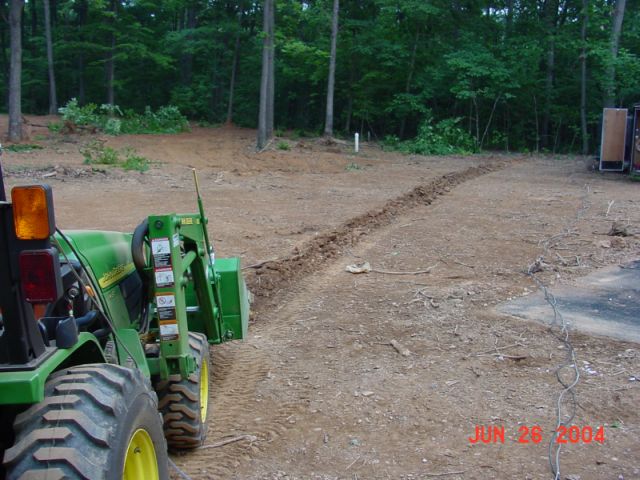

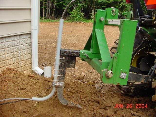

Sory I got to this post late, but hope these pics will help you or someone else....
I built a tool to bury wires out of a shank for a box blade. I attached 1" grey PVC to the rear of it to feed the cable into the ground. The pipe is attached with a hose clamp and cable ties.
I used it to bury wires ( A 10-2 electric, and a phone wire) to where my shed will be located, I did this while building my house so there was no grass to disturb.
First pic: I first ran the ripper through the ground a couple time to loosen the clay/shale mix we have here and laid out the wire (right side of picture)

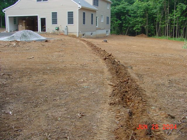

   / Subsoiler and burying electric wires #33
Up close picture of the "thing" I made, the wire is threaded through, ready to start...

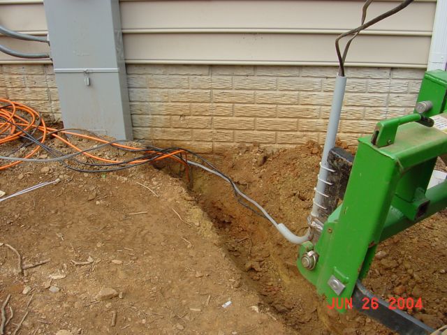

   / Subsoiler and burying electric wires #34
Another Pic...

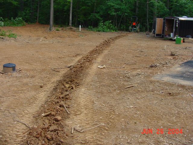

   / Subsoiler and burying electric wires #36
The wire is now buried at about 10-12"

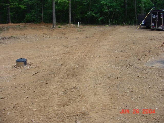

   / Subsoiler and burying electric wires #38
I finished off the trench by driving over it a couple times to press the mound back down.
That's all, I hope this help's with some ideas /forums/images/graemlins/grin.gif

A little late, but I have always heard that you aren't supposed to bury alternating current and phone lines in the same hole...
David from jax
