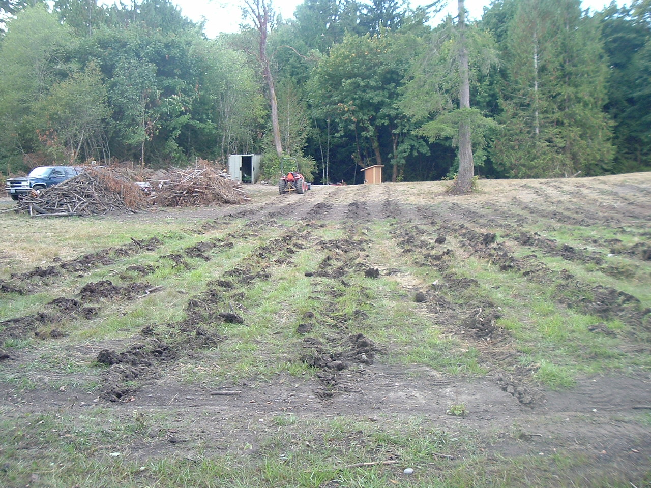

I ran the TSC subsoiler to maximum depth about 5 feet on center. I had created a drainage ditch and the subsoiler allowed me to create underground tunnels, aerate, and generally uncompact the clay soils in rows leading to the ditch. I pulled the single shank in low range in 4wd which took about all my 30 HP tractor had in this very firm and dry clay. Luckily no rocks. A pretty boring job once you get the hang of it.
I noticed very early on that the subsoiler "pops" up a great deal of soil which is a pretty good indication that there is less soil underground. I actualy thought I ruined a pretty smooth field but I was able to smooth the ridges nicely. That low field is now dryer than ever with excellent improvements in drainage. Maybe next year I'll subsoil in the opposite direction.
Oh... one more thing, the subsoiler actually got warm to the touch from the friction. Cool.

Ideally when you pull a subsoiler, the ground behind you should look similar to a molehill. Looking at the results from Highbeam's picture attachment the ground was too dry (I've been guilty of making that mess too). Needs to be dry enough for the pan to shatter, but have enough moisture to keep the large clods from rolling to the surface.

Don't expect a cultivator frame to handle what you would put on a subsoiler. I destroyed a single shank subsoiler in my clay ground pulling about 20" and leaving a trail about like Highbeam and it was (home-built by a friend) built stout. After I finally got my field smoothed out enough to clip at a decent pace I realized the benefit of the subsoiling. It really helped to get rid of the standing water in the low areas.
My problem was in a field where I had planted some trees on 50' centers, and I ran the subsoiler down the rows of trees on each side, and then perpendicular to that on each side of the rows of trees. Had a heck of a mess for a while, but if done with proper soil moisture it would have been much easier to handle.
