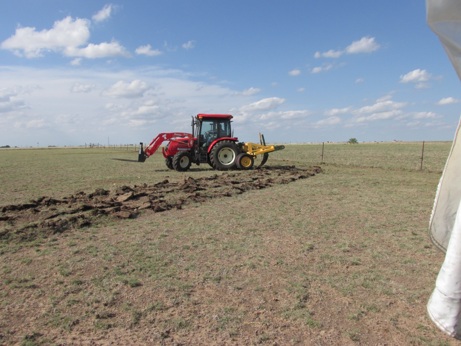

   / Subsoilers: Rankin, North Star, NorTrac, Agrisupply, Gearmore all the same? #8
My subsoiler
Doing my pasture

The Hay King then is your best bet. They make a C3 (3 shank) that will probably run with about 30 hp in the lower range gears. Doing a garden, you don't have that much to do so the fact that you have to go slower with lower hp is no biggie. The Hay King is more of a renovator, not a "Plow Pan" buster like Travlitts. THAT is one mead dude.
I just dug up a garden in clay that hasn't seen steel for over 40 years for a neighbor using the Hay King with 3 passes (straight line and an X) and then a 3 pt roto tiller with 2 passes and it's perfect.
