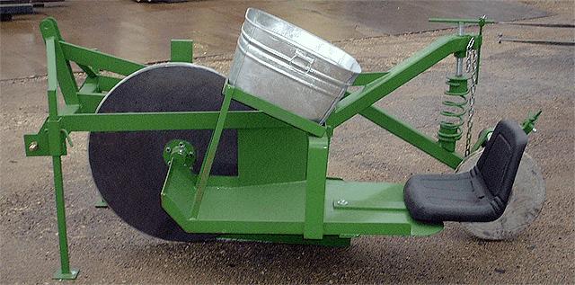

Here's a pic of the real thing:

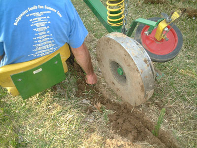

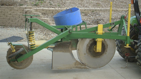

some more pics of tree planters you can buy....
