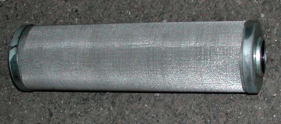

   / Suction filter killing performance, need better options. #16
I would get a 150 mesh screen.
That's the approach I took for this McCormick. I took apart the inlet filter and saw how it was
made. McCormick wanted crazy money to replace it AND some hydraulics experts think
that any inlet filtration is not advised.
So I bought some 150u stainless steel mesh and made up my own filter (2nd photo).
Nice work! Were you able to use the stock housing?
   / Suction filter killing performance, need better options. #18
Thanks. Fits right into the inside of the tranny housing. I epoxied the mesh into the steel
end pieces. A spring holds it under pressure against the end seals. This tractor was an
'05, made by Landini, and parts availability was quite poor.
