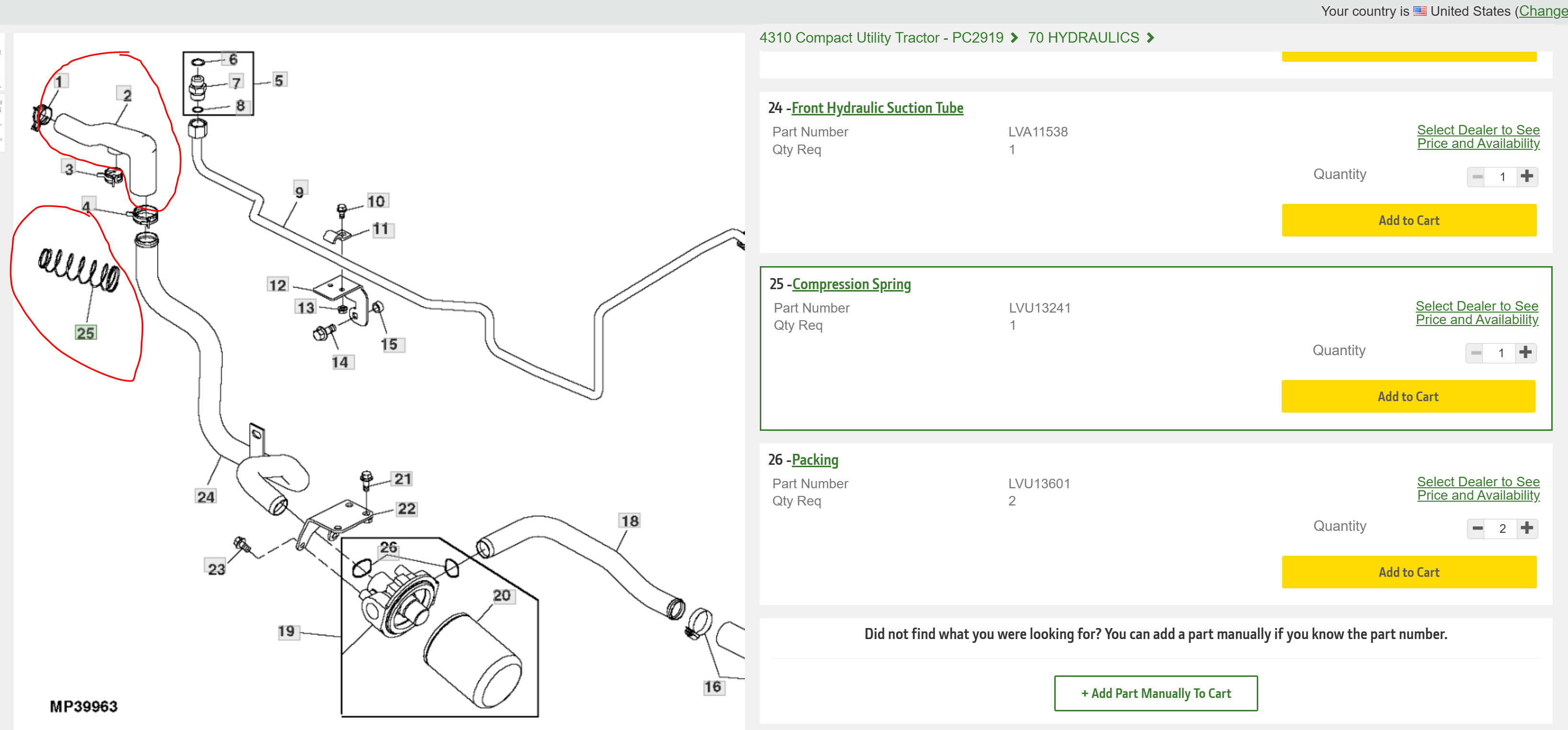

Roger are you saying that there is supposed to be a coiled spring inside the F shaped manifold that sits on top of the hydraulic pumps?
Wow...old thread!!!!!!
But, yes, here is the parts diagram. Those rubber manifolds are well known for cracking and allowing the pumps to suck air, causing cavitation. They are cheap to replace.

Thanks. Finally got the spring into the manifold and it seems to be helping.
   / Suction manifold hose collapsing #10
cleaning the screen fixed the problem for the OP, If you just install the spring it is a bandaid that masks the real problem which would be a clogged intake screen.
