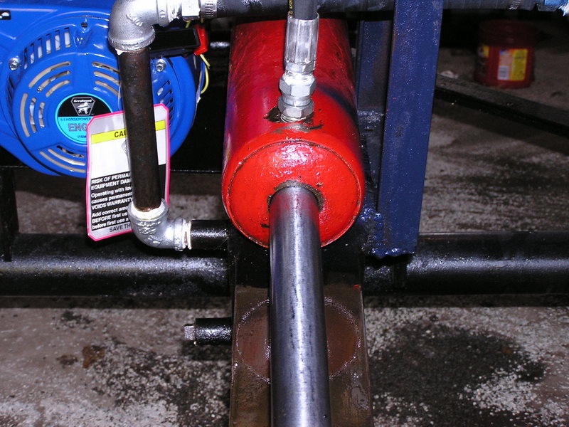

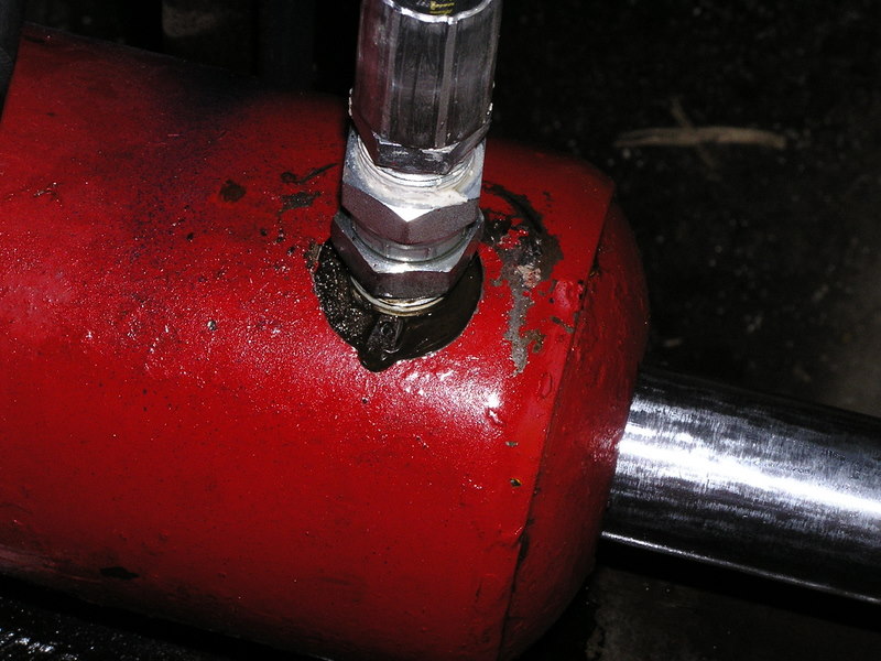

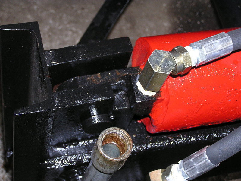

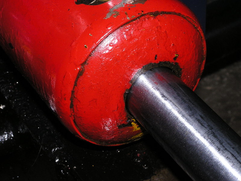

So, any body know how to get this cylinder to come apart? I can't find any place you
could place a spanner wrench or anything for that matter. I am thinking this thing maybe
a bit on the old and out of date side. Maybe time for a replacement is what I am saying.
Phil C.

I don't know much about hydraulics, but doesn't it look like the endcap of the cylinder is just crimped in? It does not look like it comes apart to me, except with a nice band saw or something.

Take out the fitting (it's keeping the gland from sucking back in).....then use a chunk of alum or brass to whack the gland back in.....that may expose a hidden retainer ring...:).............or the gland was installed from the back side and the base plate (back side) was welded together afterwards......:mad:
It does look like an odd ball.........:confused2:

I t looks like the the end is crimped like the disposable air cylinders we get at work.
With that in mind are you sure its a hydraulic cylinder?
   / My no split log splitter! #36
Definitely looks like a throw away cylinder type, it maybe not designed for modern hydraulic pressures anyway. I suggest replacing with a new cylinder, try to get one with a 2 inch rod.
#37
Decided not to torture myself any more. I am done with troubleshooting at this point and have ordered up a new replacement 4X24 2" rod piston. Found one for $149 + shipping at Agri supply. Why not, at that point I will have a new splitter as far as Hydraulic components are concerned. In the future I am going to think twice before taking on someone else's already started project. I should of started this one from scratch. Live and learn.
