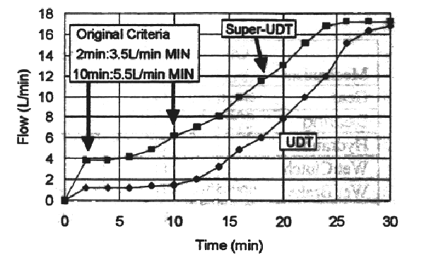

Click the attachment and make your own choice!
/forums/images/graemlins/laugh.gif

Ah, that clears things up. I guess that's why they call it 'super'.
As for the graph, thanks. I don't know what it means but the super udt line is higher than the udt line so it must be better. But seriously, that is good solid objective data, and that helps.
But this question remains: if sudt is always better in every way, that means udt is always inferior in every way. Why would Kubota, any dealer or any owner ever make it, stock it, sell it, or use it?
Here is what the cynical side of me thinks: UDT is perfectly sufficient for virtually all applications and conditions since it is recommended by Kubota and Kubota does not specifiy when or where SUDT will actually improve performance or protection over UDT. Plus, I'm pretty sure they come with UDT in them. And while SUDT has the potential to provide some theoretical benefit, it is unlikely to be objetively evident regardless of the machine, use or weather.
Here is what the less cynical side of me thinks: SUDT has 'super' in front of it and UDT does not, plus SUDT costs more. And since I only want 'super' stuff in my tractor, that's what I'm going to put in it! /forums/images/graemlins/grin.gif
