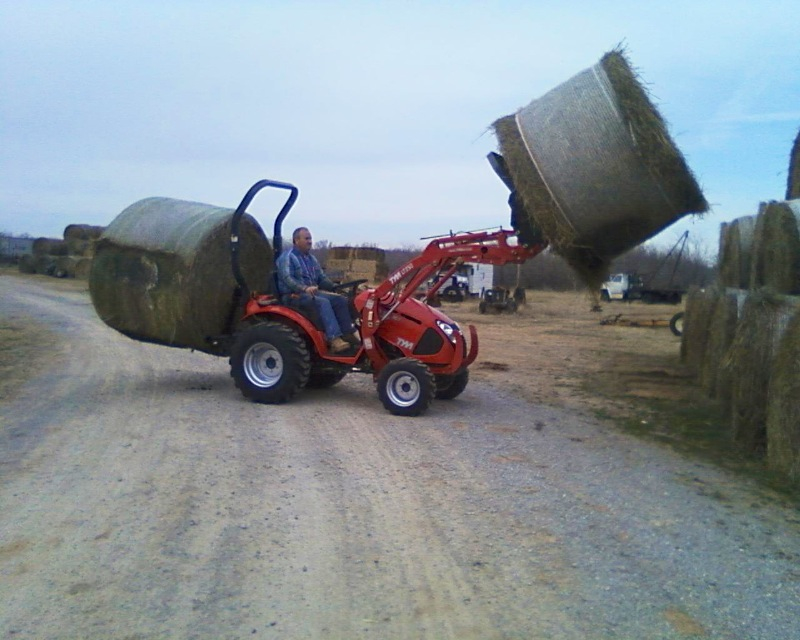

Bale handling on a friends farm picture.

This has got to be my favorite bale mover!
