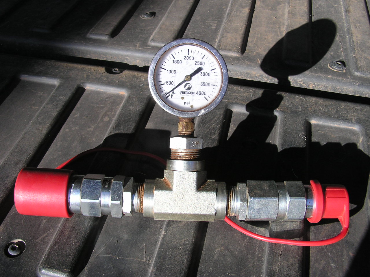

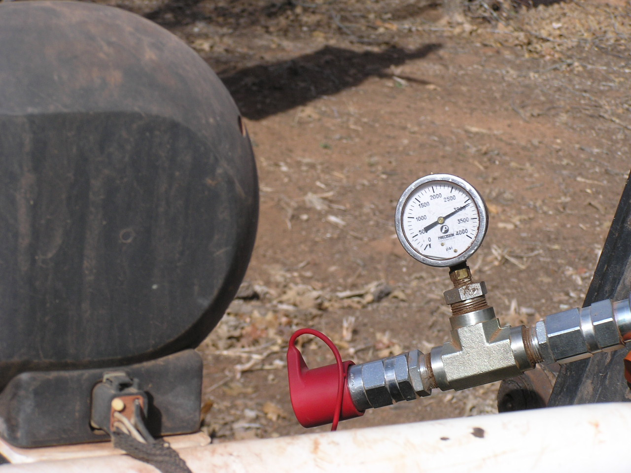

It's too cold to do anything outside, so I want to make a pressure tester. I'm thinking a T fitting with a female quick disconnect, a male QD, and a 5000psi pressure gauge.
Your thinking is what I did, but I used a 4000psi gauge:
The view of relief pressure from the V417 seat:

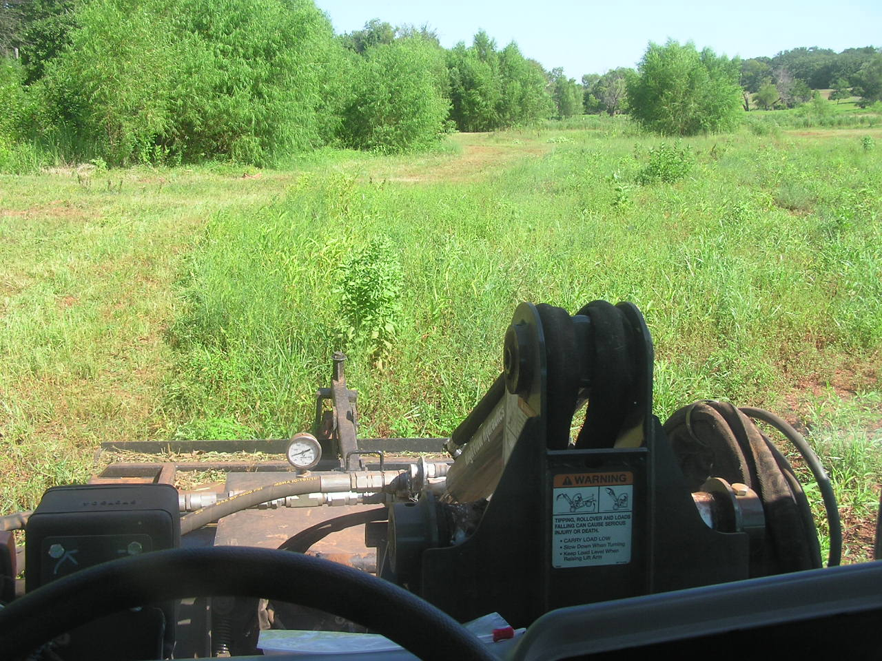

If you use a hose run it from the tee to the gauge so you can monitor the working pressure.
I can see the pressure on the brush hog, 500 psi in grass, goes up over 1000 in brush:

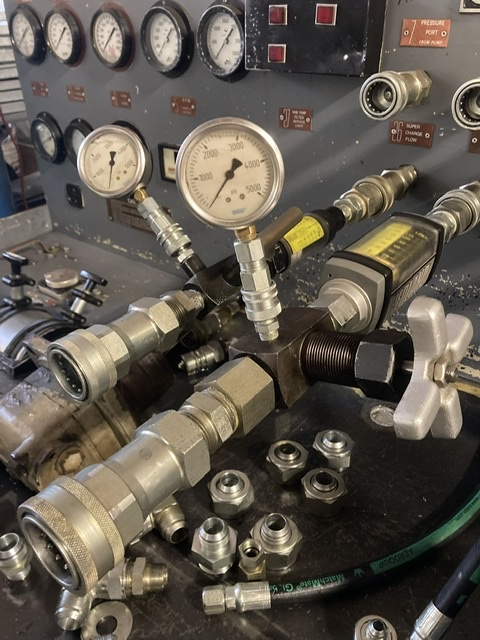

Hyd gauges are most accurate in the middle of the scale, I like 5000psi for most systems but add a quick connect to change guages.

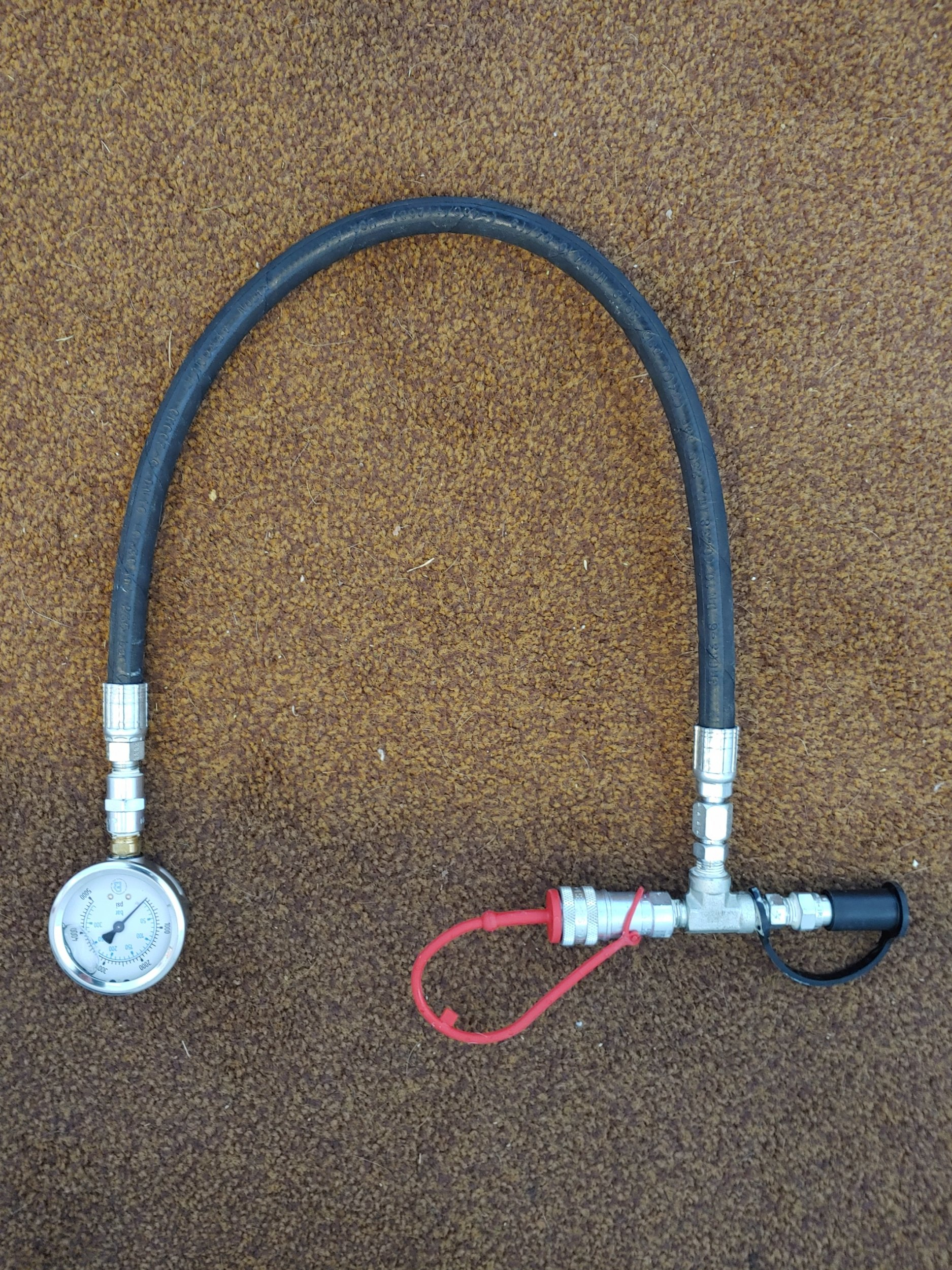

Mission accomplished, I forgot I had a short length of hose and a male QD left over from installing my rear remotes, so I went to the local hydraulics shop and got the rest of the parts. I even managed to use 2 of the dust covers I bought 10 years ago. Thanks for all the suggestions.
   / Suggestions for a pressure tester #15
Looks like winner to me....
