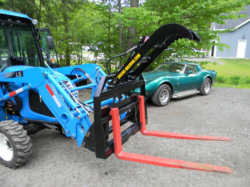

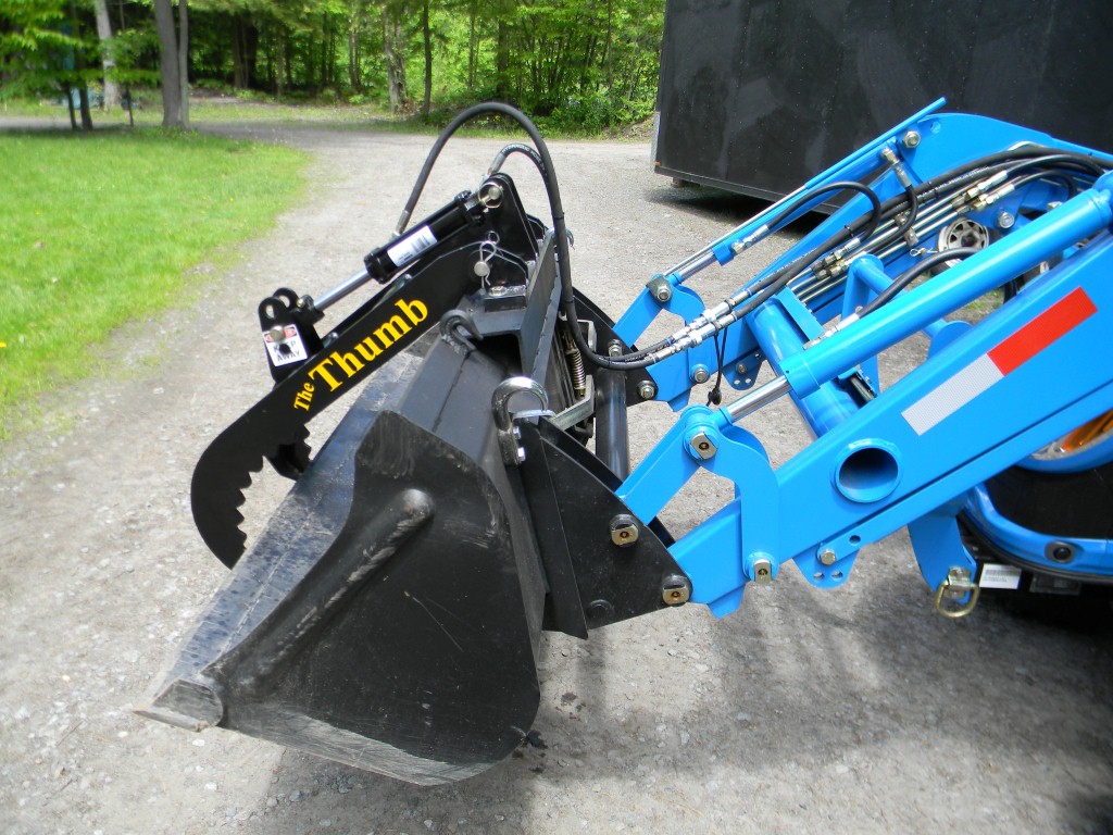

Love your grapple forks George? Is that an add a grapple like "the thumb" or did they come like that?
   / Suggestions for rear 3pt pallet / log forks #19
It is called The Thumb by Greensmachines. I bought the thumb with 2 base plates and modified my forks and bucket so I can use it on either. (I have a thread on the build but couldn't find it to provide a link) I don't have a use for a full grapple but did for a hydraulic thumb which is less than half the price of a full grapple.
