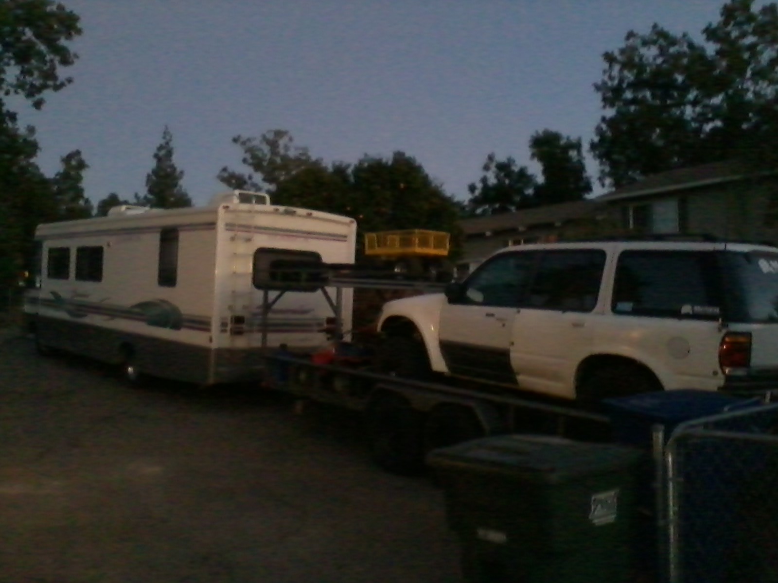

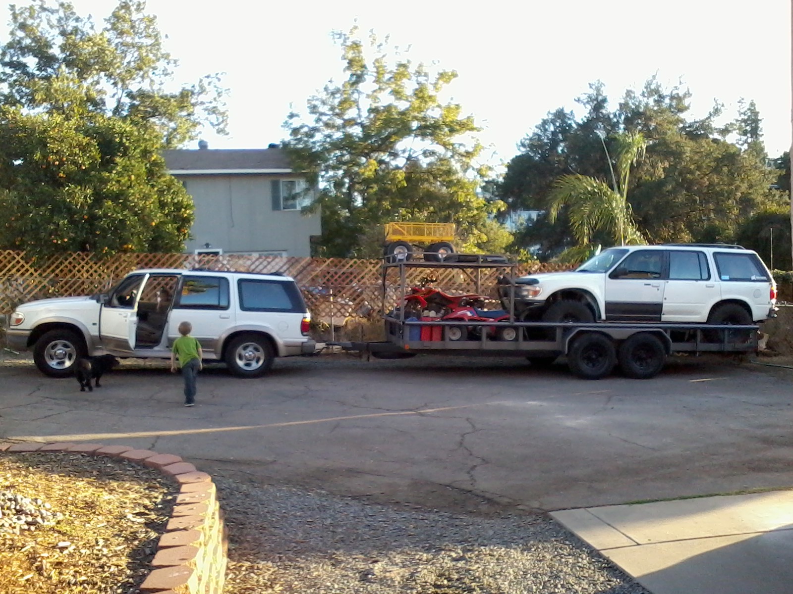

My trailer is 2900 with the rack. Im taking the rack off which is 300 putting my trailer at 2600. I have checked the tags on the axles and they are 7200 a piece, so 14400 total.
As far as deck space. The tractor is 11' no loader, the bush hog is 6' (if lifted on sideways) thats 17' (18+ really). I figured thats the only way it would fit. The front axle is at 10'6" rear axle 13'.
I toyed with setting the bush hog on the front with the wheel towards the rear, backing the tractor up hopefully getting some over lap because the bush hog tapers, and putting the bucket and spikes as far up as possible and pray the arms don't hang off.
If the rear is that heavy I might have to back the tractor on to the front and put the bush hog on under the bucket on the rear. As a desert goer I have always test loaded until I found a good fit. Thanks for the input and not bashing to the new guy.
