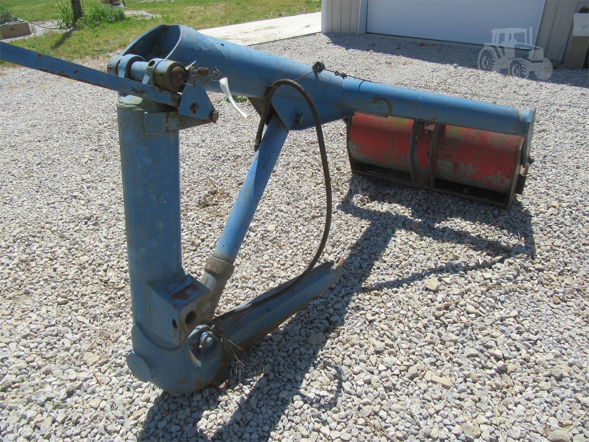

I bought an old Ford loader that has a single hydraulic cylinder. Its a one arm loader, no reservoir or pump, as it runs off the tractor. Its a one-way valve deal I guess. One hose. I don't know a thing about hydraulics or these cylinders. The hose is rotted, its been sitting outdoors a long while.
Do I dare just change the hose, hook it up to try it? Or should I take it off without trying it and just have the shop test/rebuild it?
I guess another way to ask the question is can a hydraulic cylinder sit out for 20 years and still work fine? The "rod" was not extended so I assume its not going to be rusted.

My '64 MF sat for many years without use, probably more than 10yrs. No rust and the fluid looked as good coming out as it did going in.
If you're really concerned, you could flush it first maybe my disconnecting it, extending it using the pump, disconnect the line and compress it by whatever means necessary to get a look at the fluid coming out.

the one way cylinder is collapsed, there is very little fluid in it, the loader will no hydraulic down pressure beside it own weight,
   / Suggestions on testing/using old cylinder on Ford tractor....use it or rebuild it #4
New hose and good to go.
It does not have much value so a new cylinder or even a seal kit would be worth more than the loader.
Dave M7040
   / Suggestions on testing/using old cylinder on Ford tractor....use it or rebuild it #5
I’d swap the hose try it out. I do agree with checking the fluid before it could contaminate the system

Thanks. I'll try a new hose and see what happens.

Since the cylinder is single acting, it is simple to avoid contaminating your system.
Before you install the loader and after the new hose is installed, hook the hose up to your tractor and extend the cylinder about 1/2 way.
Open the end of the new hose or cylinder port and manually compress the cylinder forcing the fluid out.
Most of the fluid will be your tractor's fluid which you throw away.
