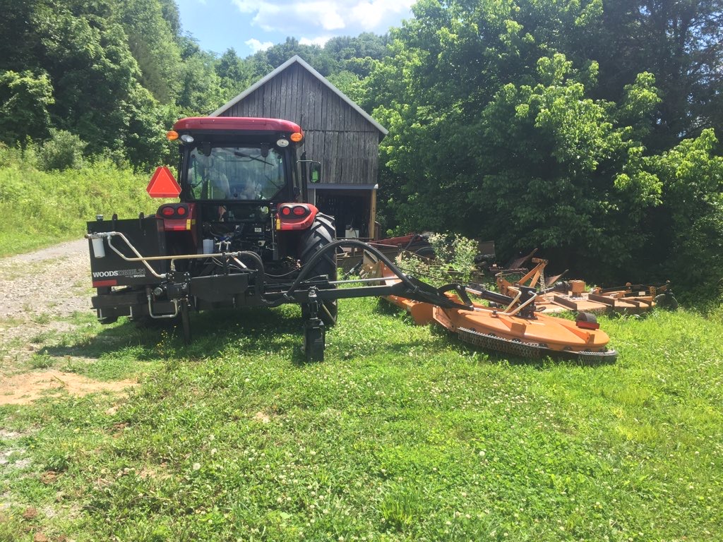

I have a Woods ditch bank mower. DBH-5.30. It works really well for areas like you show. With the mower deck extended, it will mow right at 9' out from the tractor tire.
But, it's heavy. About 2,000#s. And Woods says you need a minimum of 60 HP at PTO.
I bought to mow the same type of locations as you- creek banks, sides of driveway, and under woods lines.
