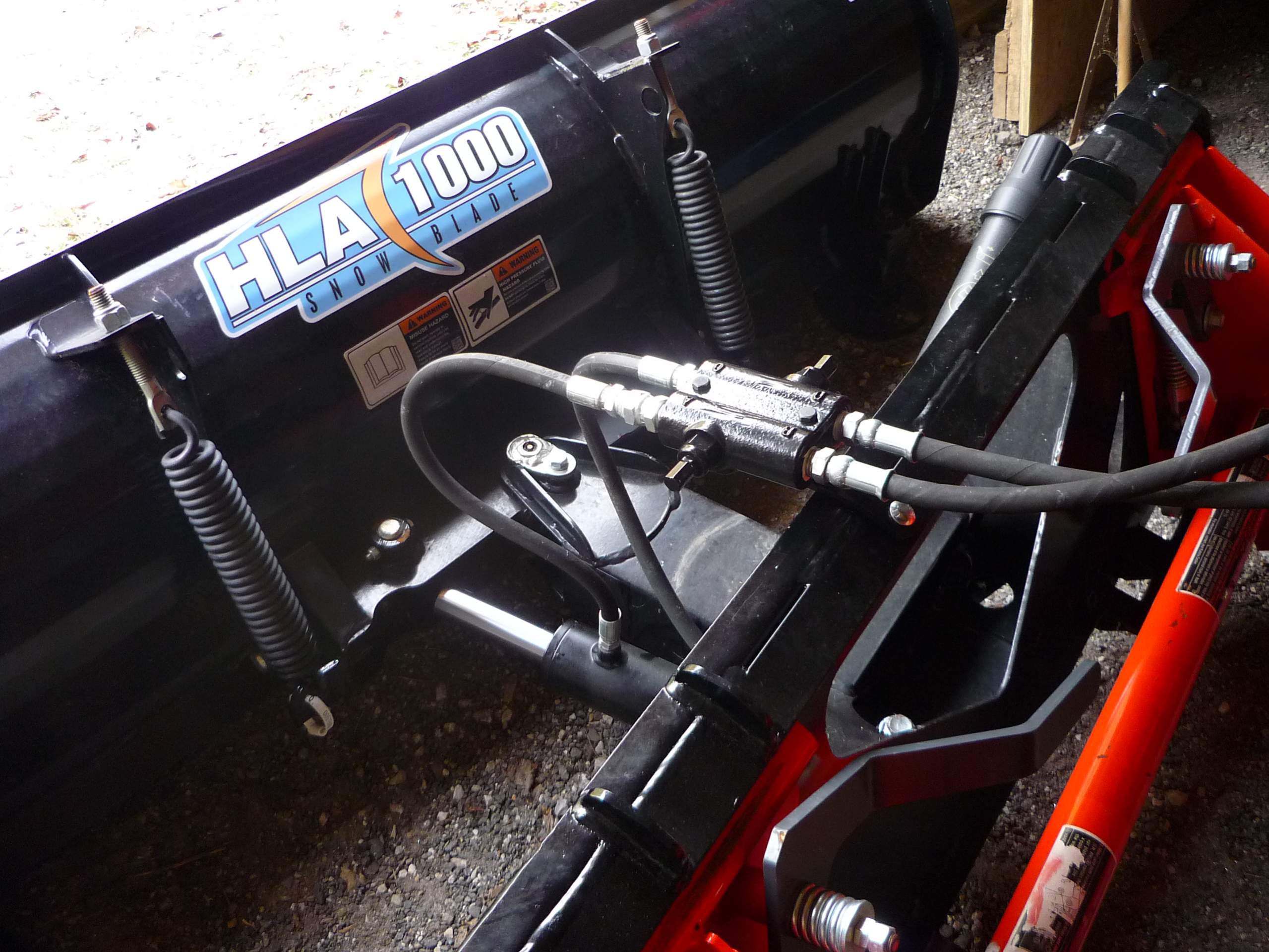

So what's a Skid steer control for the FEL?

Not skid steer control, but rather a system where the loader bucket, or forks, or whatever you need is attached, and quickly removed, from the loader arms simply by pulling two pins using some levers. It is a standardized system, so different attachments will be interchangeable. If you look at the photo, you can see two gray levers- which pull the pins, letting you tilt and back away, leaving the black plow structure on the ground. You'll find much better photos and explanations. Just be aware of the feature...

If you're referring to my post about skid steer FEL, I was referring to the connection of the bucket to the frame of the FEL. Many tractors today have settled on "skid steer quick connect" as a standard. With that you can but many aftermarket attachments to replace the bucket, like a grapple or many other various things. But some tractors have their own proprietary attachment systems so you're limited to their specific brand, and changing the implement requires tools and time. Whereas with quick connect, it can be done in seconds without tools. The trend now ( as I understand it) is the skid steer connection is becoming the standard and is more desirable. With my older Kubota, only a Kubota bucket would work. And no Kubota grapples were made. So I had to buy an adapter for $1000 to make it work. So if I were shopping and had my choice, a tractor with skid steer quick connect on the FEL would be preferable. It gives you many more options and can save money.
Hope that's clear. I'm not sure what connection systems are on tractors in your horsepower range, but I would want to know.
Of course if a bucket is all you'll ever use on the front, and you never plan to take it off, guess it doesn't matter. But if you foresee wanting other front mounted implements, most available now are designed to be compatible with SS Q attachment systems.
