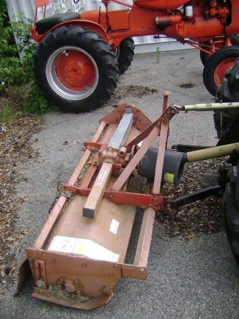

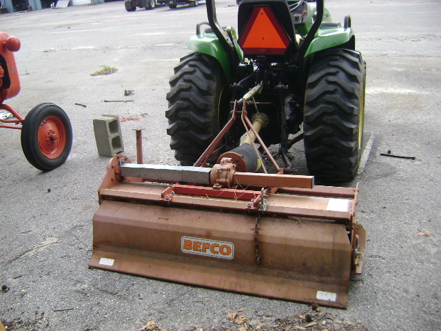

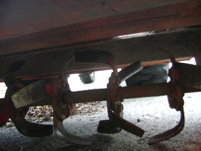

I'll grab a pic of the tiller. Anything we need to check out maintenance wise on it before using it? Ultimately, I would like to paint it red to match the tractor.
   / Suhweet!
This thing has probably not been used very much, just weathered.

Anything we need to check out maintenance wise on it before using it? .
Grease the PTO shaft. Check/fill gear oil in right angle gear box. Grease the right side auger shaft bearing. Make sure the chain case on the left has grease in it. When I got mine used, I took the cover off cleaned out all the old grease and replaced with new. Nice find :thumbsup:
   / Suhweet! #7
One more thing... make sure to loosen up the slip clutch and make sure it slips.
