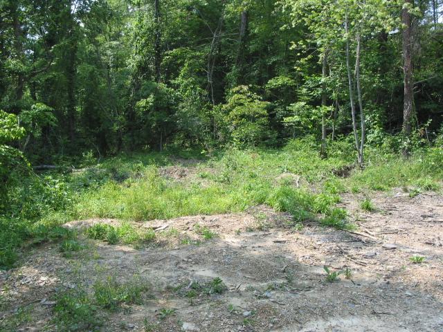

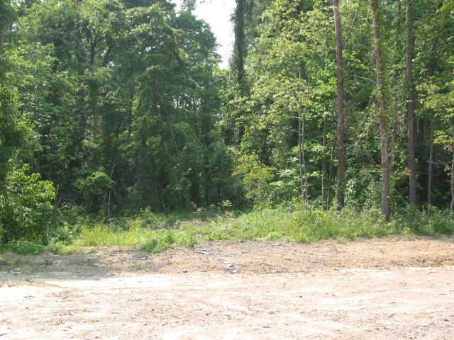

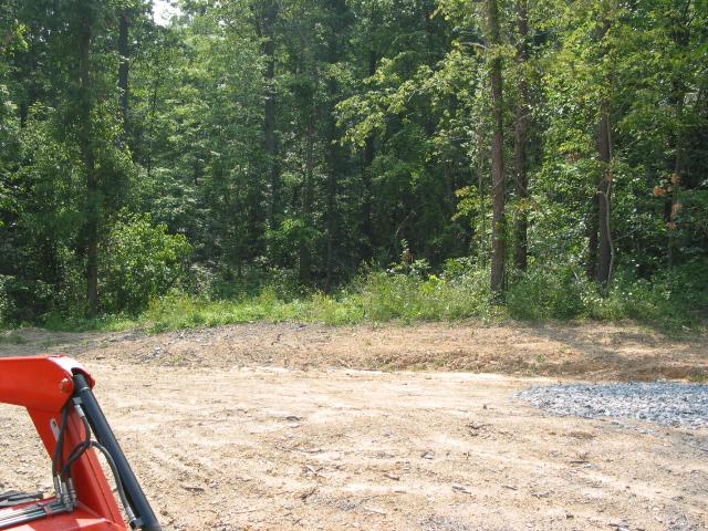

We need a waterproof place to store some belongings for the next several years until we get a detached garage built. The intention was to purchase a 40 foot sea carrier and place it near the garage side of the house. Does anyone for see any problems with this site work plan?
Skim off top soil
Build a level pad with clay/medium shale to surrounding grade level
Possibly lay down a sheet of 6 mil plastic
Put down 4 inches of #4 gravel
Set sea carrier on gravel
I'm not sure about the benefits of laying the plastic down. It might be a vapor barrier, but the gravel will probably poke holes in it. The gravel seems like it would help with drainage and keeping it dry under the carrier. Number 4 gravel is what we are using for the driveway base and we plan on getting more to finish the driveway. I don't want to go overboard on this project, but it would be good to keep the carrier in good shape for future uses. The reason I'm asking for your opinions is because once the carrier is set down, it's to late now. The three attachments show the site area. Thanks!

That sounds like it should work out just fine. You may want to put down five or six 4x4's on top of the gravel and have them set it on those so that you can get some air flow underneath the container.
   / Suitable Base For Sea Cargo Carrier #5
I bought a 20' box from mobile mini and had it delivered. the spot we set the box on was on a slight slope and the box was set parallel to the slope. I Jacked up each corner of the box with a farm jack and placed 2" 12x12 pads under each corner as necessary to level the box. I then built a wooden ramp to the front of the box and put some gravel out front to keep the mud down. This setup is temporary and meant to be a secure storage area for tools and equipment until I am a permanent resident on the land. Works great! After I move here and get a shop built, the storage box will probably be buried into the hillside and become a storm shelter. I am going to the land this weekend and will try to get pics.

gatorboy - good idea on the 4x4's. Will they stay in place when the container is slid into place or should they be pinned down with rebar?
cmuncy - I'm still working on getting quotes.
pekabu - I plan on measuring the humidity before storing anything in it. You can install vents or a dehumidifier if necessary. From what I heard, they are supposed to be waterproof.
