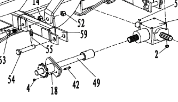

I do not have a clear understanding of the location of the shear bolt for the augur. Is it between the shaft and the drive sprocket or between the driven sprocket and the end of the auger shaft?
It's on the driving side of the chain, between gearbox and drive sprocket.
   / Suitable Sheer Bolts
#13
It's on the driving side of the chain, between gearbox and drive sprocket. If this picture works, part 42 is a 6mm bolt, and looks like a deliberate weak link. It's only fiddly because it's screened from access except from the underneath. By comparison the augur shaft connects to the driven sprocket by four 10mm bolts.

Got it. My suggestion in comment #8 is moot.
If, after a season or two of use, you find replacement of that shear bolt is a frequent nuisance, you may be able to make a hinged or easily removed access panel in the plates that screen the top without compromising the bracing such plates might provide.
