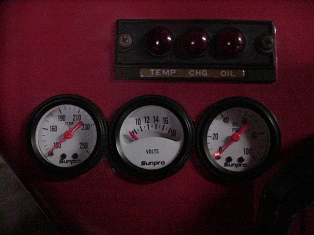

I'm not an expert so take this for what it's worth, but I think the oil pressure and water temp gauges are working on two totally different principals. That could be why one seems stable and the other bounces around. I think if you had a Sunpro water temp gauge, it would be just as good as the one you have now. As for the oil pressure gauge, does it smooth out at higher RPMs? Just wondering if your oil pressure really is moving up and down 5 psi and the gauge is just showing you what is really going on. If that's the case, I would expect it to smooth out at higher RPMs. I have a set of the 1.5 inch Sunpro gauges on my 2210 and they seem to work fine, no bouncing at all... Hope you get it figured out, keep us posted.

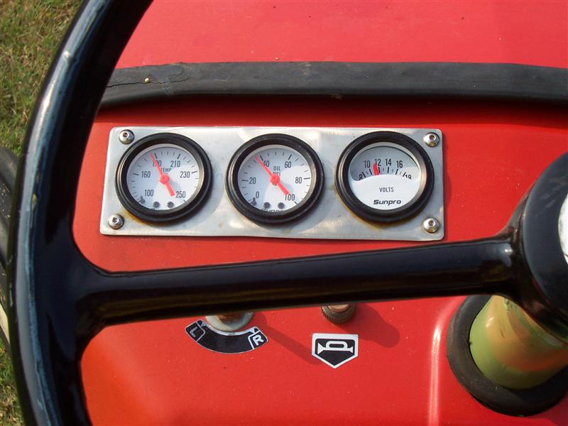

I have a set of 1 1/2" Sunpro gauges on my 1700, but the oil pressure does not jump around. The only time it fluctuates is when increasing or decreasing engine RPM. I attached a picture of mine installed.
