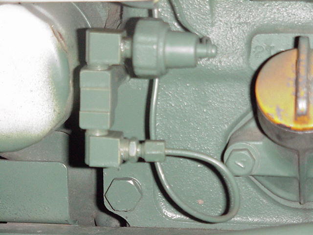

The meter pretty much bounces up and down so fast that it is just a blur. It gets worse at higher RPMS. I don't think it is showing me oil pressure variations. I will try the smaller orfice. I will also try and disconnect the gauge from the tractor and hold it in my hand, see if that makes a difference.
   / Sunpro Oil Pressure Gauge #16
</font><font color="blue" class="small">( The meter pretty much bounces up and down so fast that it is just a blur. It gets worse at higher RPMS. I don't think it is showing me oil pressure variations. I will try the smaller orfice. I will also try and disconnect the gauge from the tractor and hold it in my hand, see if that makes a difference. )</font>
I'll be suprised if holding it your hand is any better. Sounds like you might be onto something with the smaller orifice to dampen the pressure variations. I didn't have to add anything special to mine, but I do remember one of the adapters having a very small hole, maybe designed to restrict the flow? Not sure. I think it was the one the copper tube screws into. Then that fitting screwed in to the metric adapter. I'll attach a picture, maybe it will help.
