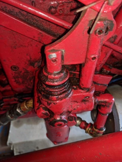

#13
id like to post a picture but dont know how advice anyone?
   / Super C hydraulics won稚 work
#14
well since i actually did post the picture can anyone tell me why this hydraulic valve is not included anywhere in the 450 page repair manual i purchased for the farmall super C?
   / Super C hydraulics won稚 work #15
I don't have the service manual, but was thinking it would be. Then again, if it's an OEM manual, there may be a supplemental manual to go along with it, for that valve. If you've never seen an original OEM set of manuals for an IH tractor, they come in a huge, like 3 ring loose leaf binder with a wide back, and stand approx. 5" tall, when laying down.
I'm guessing it was more that check valve. You can take it apart,and clean it. They are pretty simple to work on. Even at that, mine would not work occasionally. If I remember right, it takes pressure to unseat the check valve,and it could have possibly been sticking, even though I cleaned it up.
We always assumed it protected the system from a shock load. Being there are no o-rings on the control valve, and is a machined fit, hardly anything there to blow out if there would be. I use both of mine quite a bit for most gin jobs, hauling manure etc. So the weight of the spreader is hanging on the system. No problems in 30+ years. I figured the seals in the cylinder would go first, if there was too much load.
