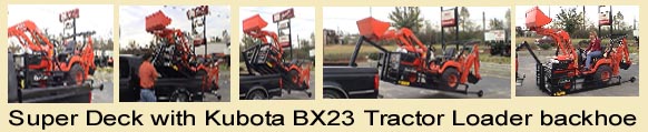

Super Deck, new product for hauling small units..
Here's an item, new in the market.
I thought you might enjoy seeing it.
Fit's into full sized pick-up truck beds.

Very interesting. The pictures in the attachment are a little small for my old eyes to see and understand, but the link provides good pictures and description.

Curious as to what holds the deck in the pickup box?
Egon
   / Super Deck, new product for hauling small units
4 long bolts with brackets secure the s-deck frame to the bed on the pick-up.

Interesting concept. I wonder though about using it with a BX. I see the payload capacity is listed as being 1,500 lbs.
In this thread Jim Wilson gave the following breakdown of BX23 weight:
<font color="green"> BT600 backhoe weight without bucket = 578 pounds
10" bucket weight (owners manual) = 37 pounds
12" bucket weight (owners manual) = 40 pounds
LA210 loader weight (approx) = 430 pounds (not sure if this is with or without the bucket - the bucket alone is listed as 132 pounds)
BX23 tractor weight with ROPS = 1520 pounds.
The tractor weight is listed on the specifications page where only tractor unit specs are listed so I am pretty sure this is the weight for just the tractor unit itself.
So if I add up all these weights using the 12" backhoe bucket and assuming that the 430 pound weight listed for the FEL includes the bucket I come up with:
578 + 40 + 430 + 1520 = 2568 pounds </font>
That is well beyond the 1,500 rating of the Super Deck. Is the one pictured a heavy duty model of some type?
Add 700 lbs for the weight of the Super Deck and that equates to over 3,200 lbs in the pickup bed. Seems like that might be pushing the limit for many pickups...
Looks like a great product. I just wonder if the BX23 might not be a little too heavy for use with it.

I do agree that it looks like the LB1914 is about to squash the little pickup under it. Maybe they need to take the rear bumper off so it won't catch on anything. /forums/images/graemlins/blush.gif

720# for the deck, plus the weight of the tractor is going to overload most any pickup, except for a 1 ton. Add to that the fact that you are lifting the center of the load significantly above the pickup bed floor (in the case of a tractor), and you've got a nice, unstable, hauling condition for the majority of pickup owners.
There's no way I'd haul a BX23 in my 8' pickup bed, even though my particular 3/4 ton has the exact same spring pack, brakes, engine, & transmission as the single rear wheel 1 ton - mine is essentially a 1 ton. I would haul that load in a 1 ton dually bed because of the more stable side-to-side platform that a dually provides.
Have I ever hauled over 2000# of material in my pickup bed? Yes, but its been loads of sand or stone that does not come anywhere near reaching the top of the bed rails, over short distances, on backroads. Put a "superdeck" in your bed with a tractor on top of that, and darn near the entire tractor (from the bottom of the rims, up) is sitting above the top of the bedrails - it's right there in the pictures.
