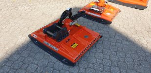

If you're dealing with rocks, I suggest using just the regular vertical spindle mower but fitted with high strength grade 80 chains instead of blades.
It's what we use on tractors, since we always find rocks. It will handle some thicker stuff too and it will just skip over the rocks without getting damaged.
It's available for excavators too.
This picture is from a 3pt mower, but it's just to get the idea of how it looks with chains. With enough HP, it can run four chains instead of two.

Yeah maybe, need to be able to cut everything from normal weeds & stickers to tree branches. The one I saw a demo of was just a typical small bush hog and it did a heck of a job. Simple and cheap, but a large rock could put a hurting on it.

I like that chain idea!!!! Never saw that before!!!! Thanks for the pics ptsg!!!
