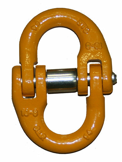

The pins hold the chains are removable to allow replacement of the chains??
That's a very simple arrangement and could be fabricated pretty easily. Thanks for the great pictures.
Yes Richard. I forgot to point that out.
With some designs, the pin will come out to replace chains. It simply holds the chain by going through the link of the chain.
Other designs use those those chain connectors, like this:
Regarding weights on the end of the chain. Some people will weld a 3" long piece of flat bar on the last link.
They claim it works very well. I've never seen one working in person though. I've heard reports of the last link getting brittle due to the welding and breaking more easily.
Just looking at the pictures it appears to be 5/8" chain? Or maybe 11/16" chain? Sorry I don't know what that compares to in metric size.
