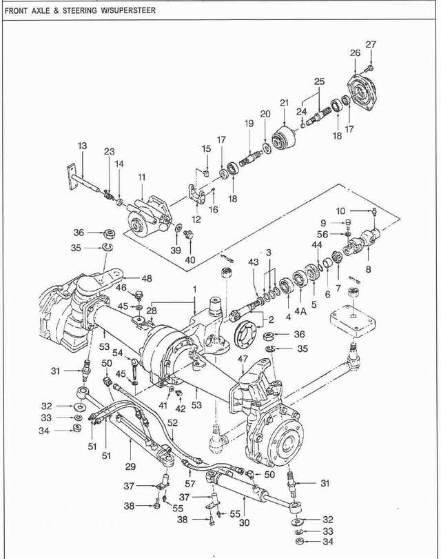

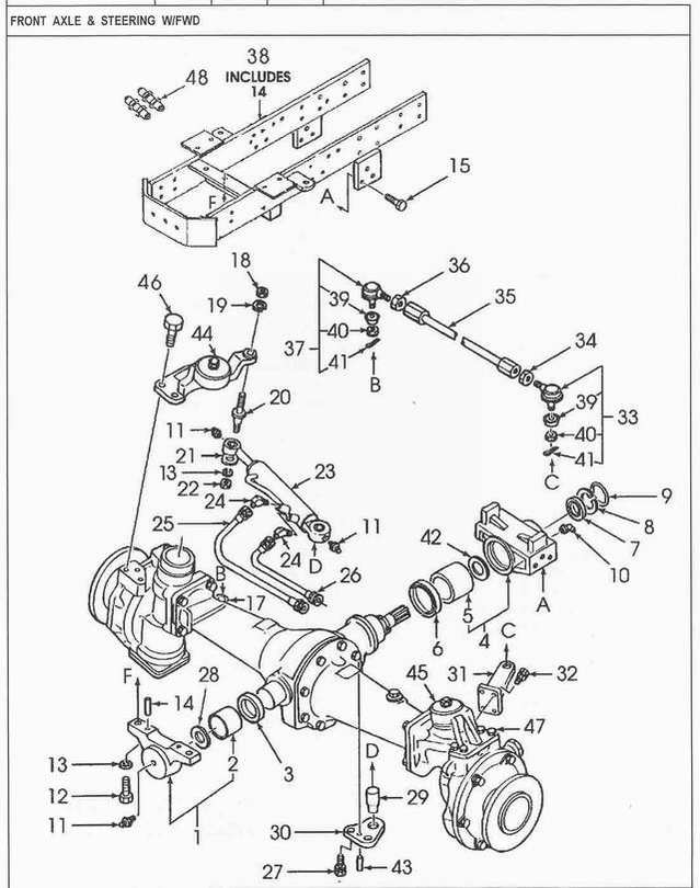

I can't speak to the operation of super steer, but I do have the details of <font color=blue>how</font color=blue> it works on the Class III Boomers. I've attached the non-ss mfwd illustration to this post and I'll post another following with the ss + mfwd axle.
JimI

   / Super Steer #13
Here is the super steer illustration attached.
JimI
