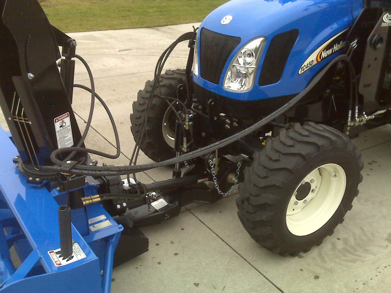

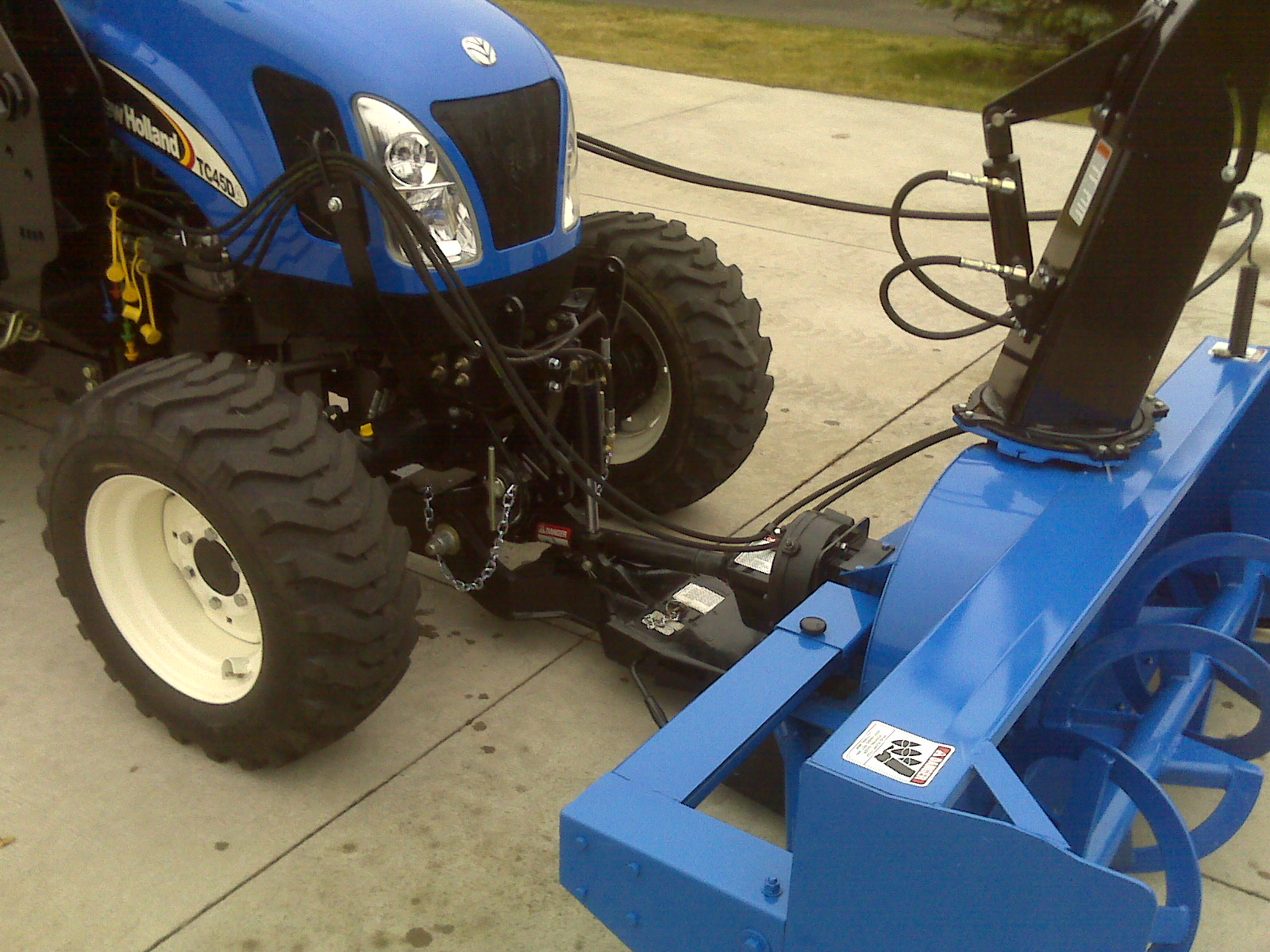

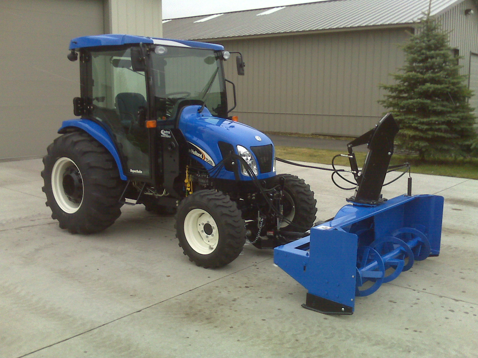

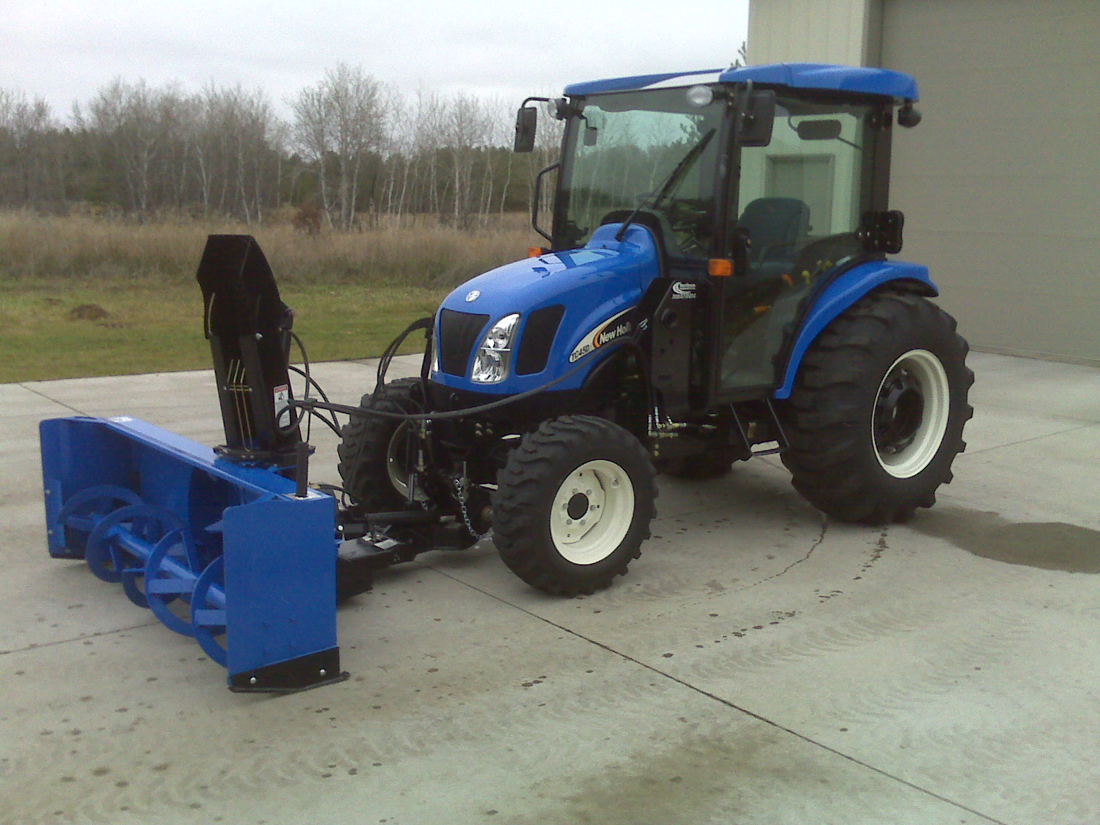

Here are a few pics of my setup. We had some decent snow last year and it worked very well. The blower is a NewHolland 72CSH with hydraulic chute rotation and deflection. Let me know if you have any questions.

Questions.......... 45DA'ers
1- What engine RPM do you have to run for your 2000RPM mid PTO speed. [my JD2240 runs the rear PTO @ 540RPM @ an engine RPM of 2100]????
2- Most front blowers have a chain reduction setup to lower the Mid PTO RPM, so the front blower impeller is not running @ 2000RPM. Do you have any idea what the impeller RPM for the 72" is??
Ask for questions, and you will receive............... [[ Thanks !!! ]]
JerryK
1) NH recommends that you run the tractor at WOT (approx. 2850RPM) when blowing slushy/wet snow to minimize the risk of clogging the chute. I have taken that advice when blowing heavy snow and have never had the chute clog. It will even blow slush fairly well if you desire. In the lighter snows I'll bring the RPMs down to the 2300 to 2500 range and it will do just fine as well. I'll have to get some action shots this winter and post them...it can really blow the snow a loooong ways and it's fun. I can never get enough seat time blowing snow. Of course the cab helps that out quite a bit. :cool:
2) I went through the manual and don't see any reference to the RPM on the front blower. Only thing I can say is that it's fast enough to easily blow snow 40 to 50'.
