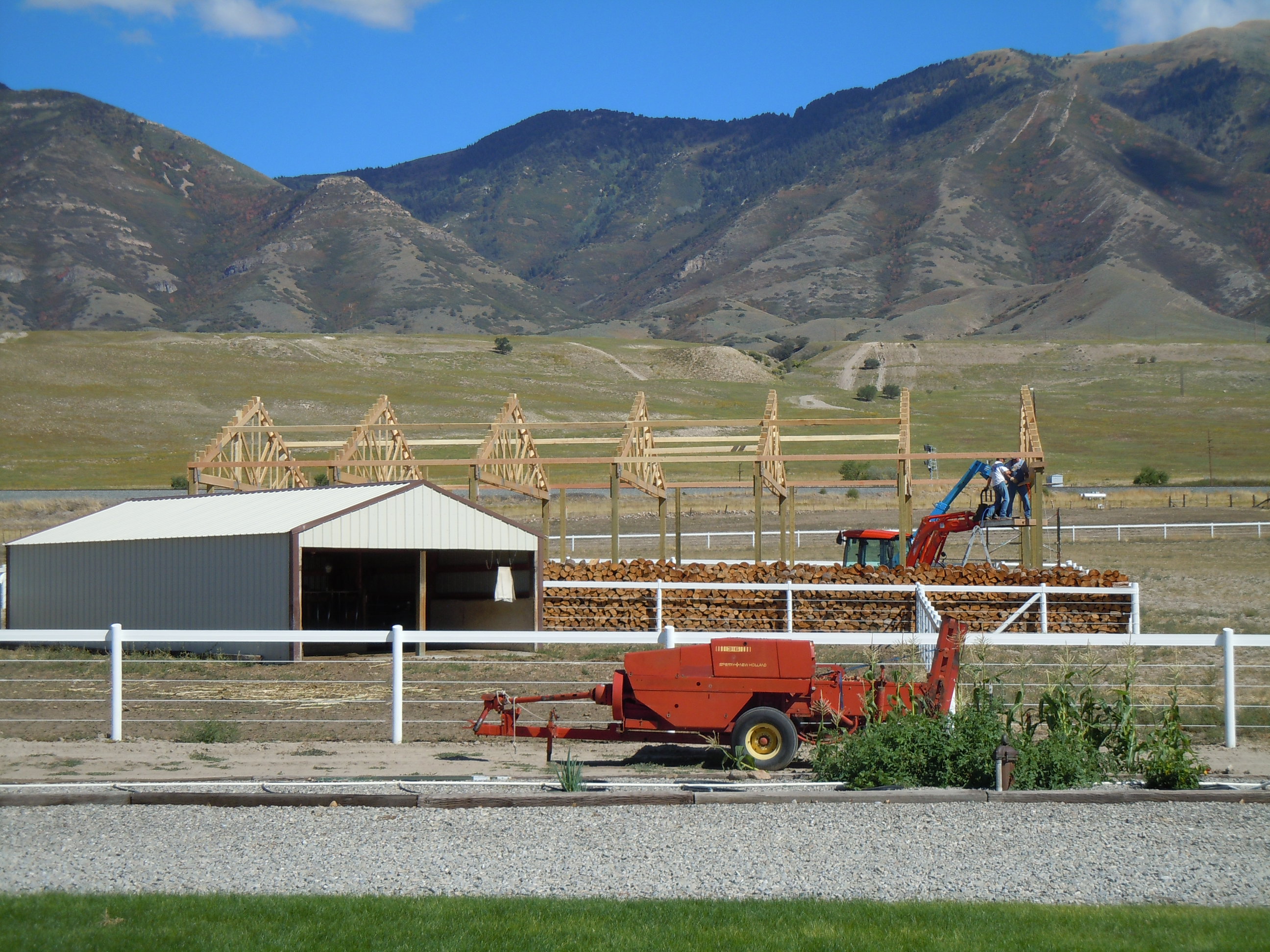

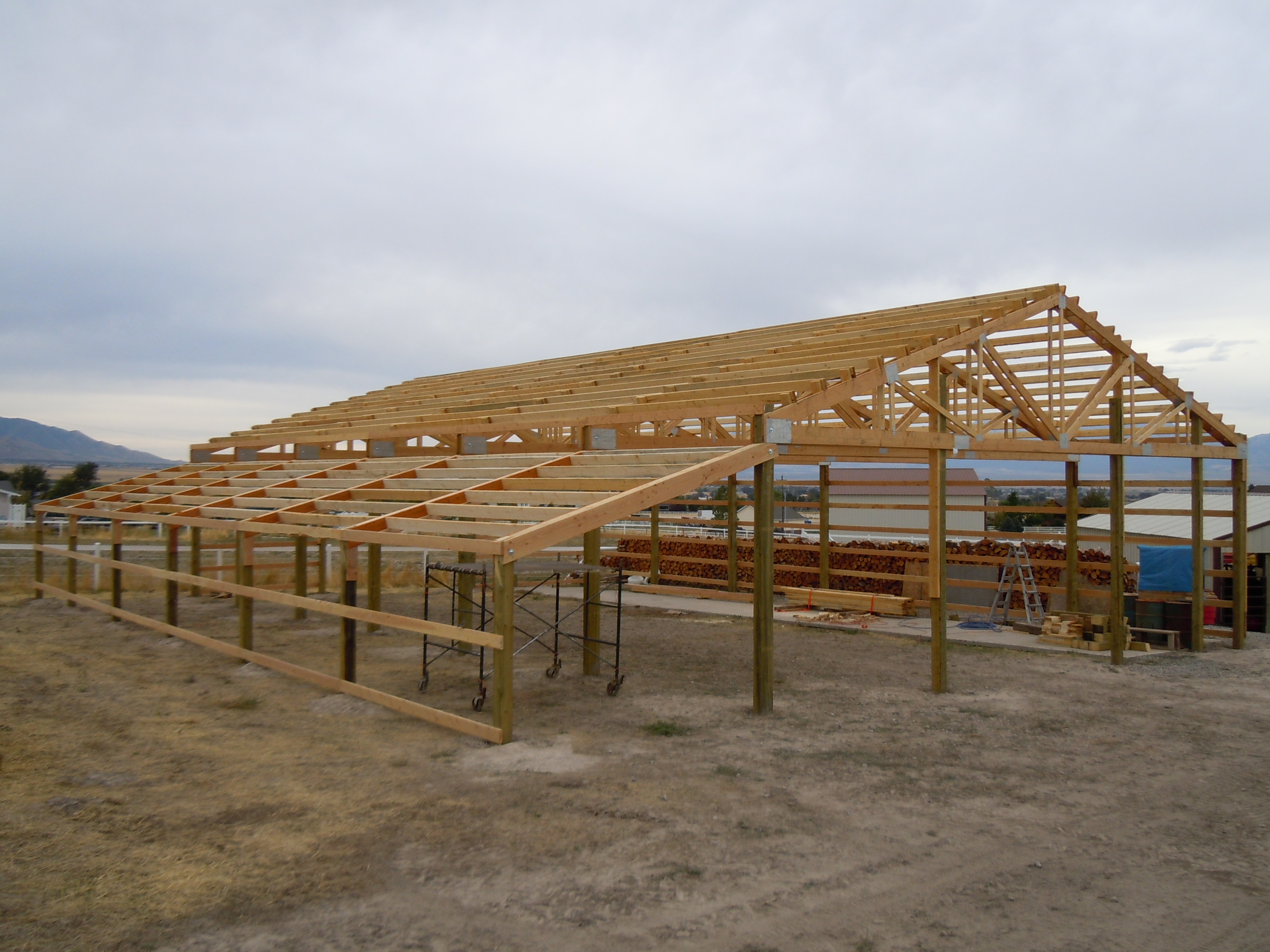

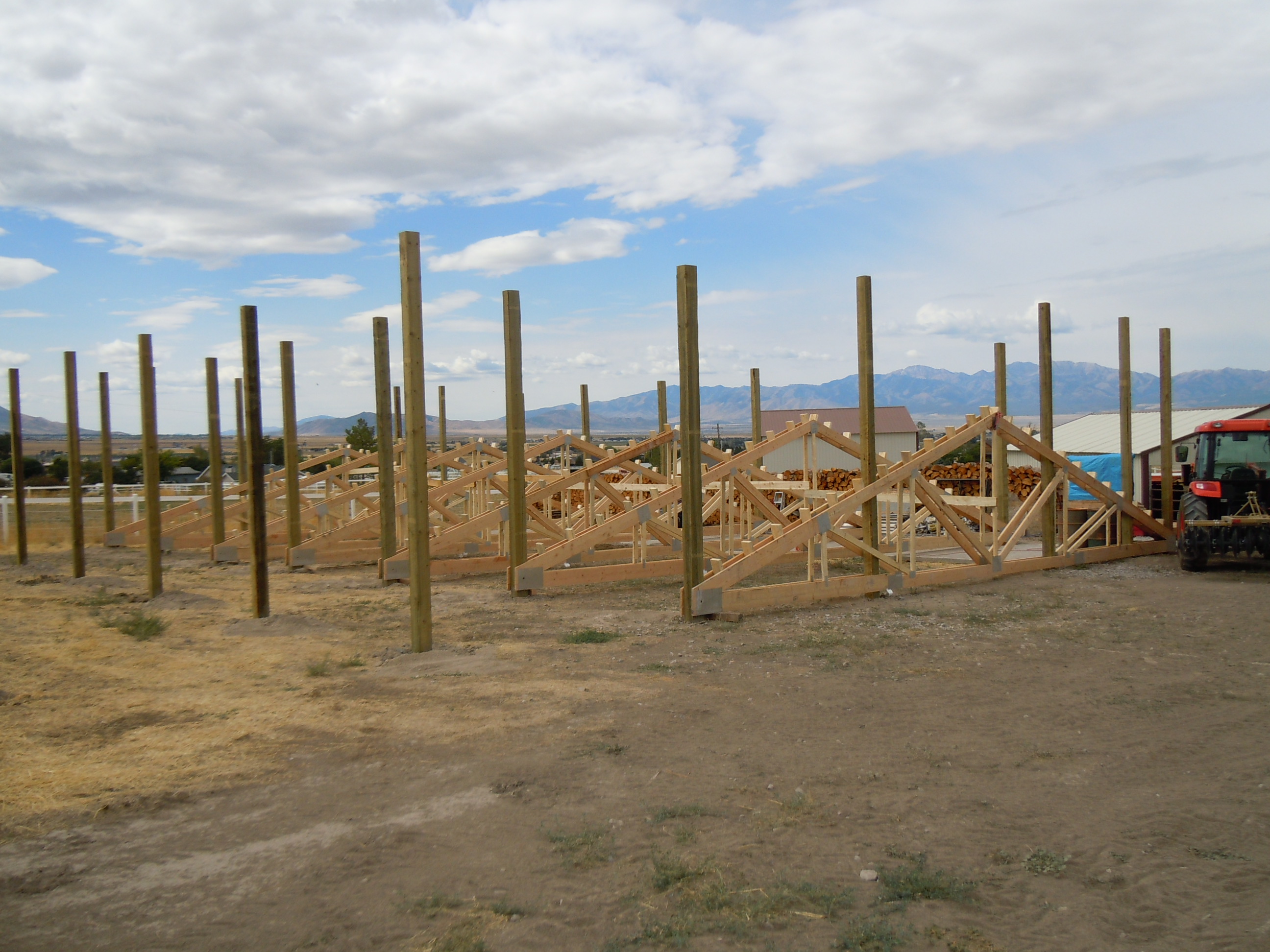

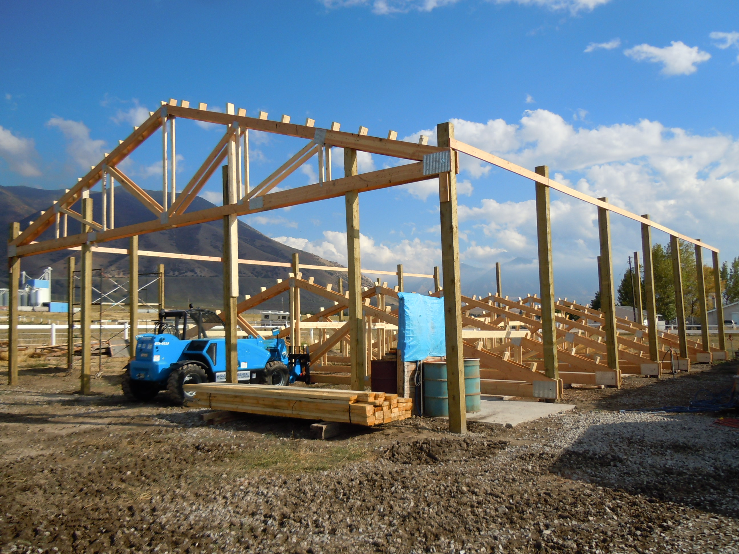

I think if you just changed your size to 30' X 30' and spaced your 6" X 6" post 10' apart it would would out great. The metal comes in 36" wide and heavier gauge comes in 39" wide. Here is some pictures of a barn I built two years ago. My post are 12' apart, but I'm 72' long. I think it's similar to what you are wanting to build.
/ Support spacing for pole barn structure #8
Not sure why the one picture turned out so small, but that's the finished barn.
/ Support spacing for pole barn structure #9
Click on it twice and it becomes a good size. But it is turned around from the others.
