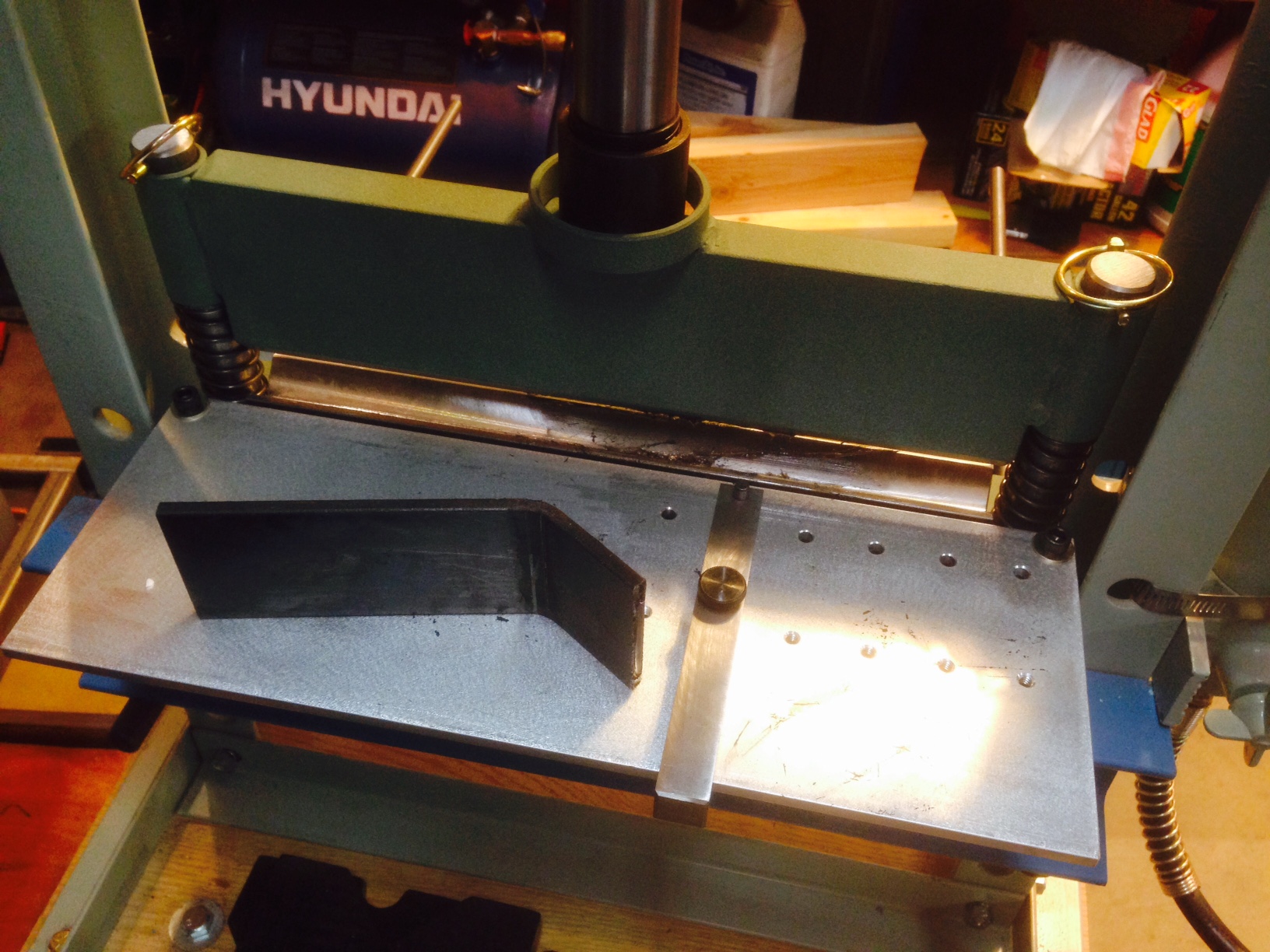

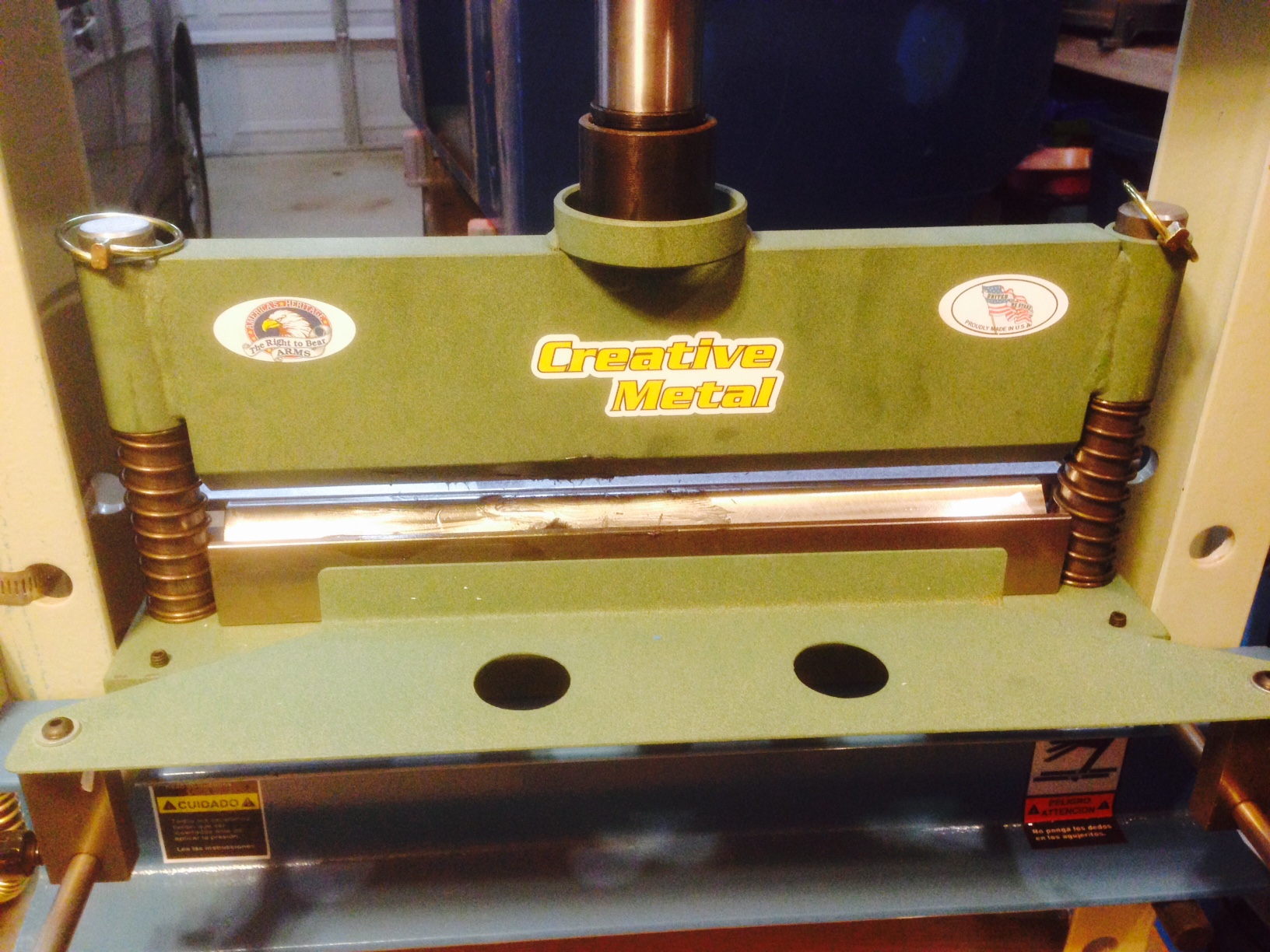

I was debating whether to make my own small press brake, then came across this brake on Ebay for $250. It is made in Stevensville, Montana. To save time I went ahead and bought it. I've made a couple test bends on 1/4" material, it works fine.
I found one other press brake thread on TBN which has a lot of good info and pictures in it:
http://www.tractorbynet.com/forums/build-yourself/220963-handy-bend-vs-swag-20-a.html
Here is the Ebay link for the Stevensville brake:
Supreme 14" Press Brake w Front Guide Plate Rear Back Stop 20 Ton Capacity | eBay

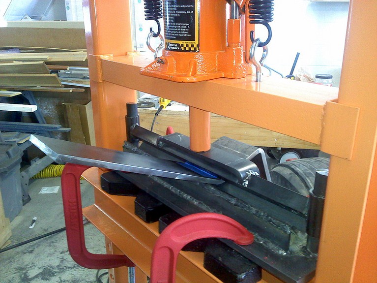

May I ask. How does it work? ? It don't seem to work like our 4 ft break or a bender
   / Supreme 20 ton press brake #3
You put it in a "H" style hydraulic press. The top part is an angle like the point of a "V" and the bottom is open like the top of a "V".
Insert metal between the two and press the top into the bottom and you bend the metal, the lower you go the more angle you get.

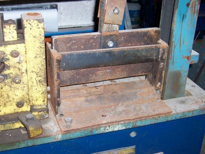

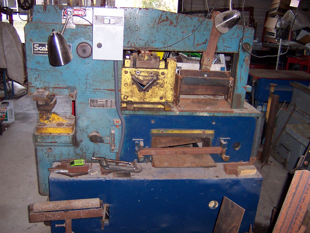

Here are pics of one that I made from scrap to fit my 50 ton Ironworker.
I can bend 1/2" X 4" with it.

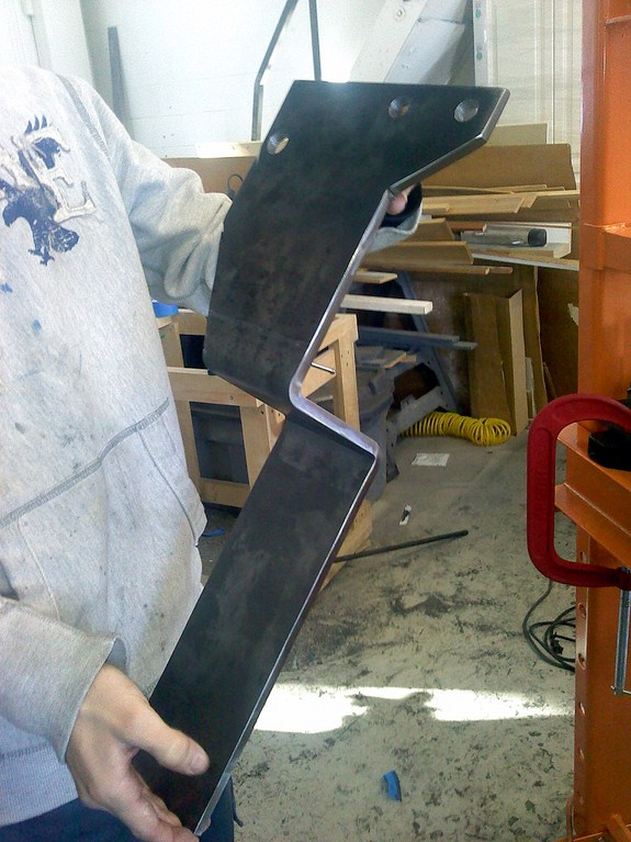

I made one a few years back to use with a Harbor Freight 20 Ton Press when I needed to do some fabrication on my Jeep. Just used it to bend some 1/4" to make a couple skids for my bucket.
Bucket skids...
Bending some 1/4" plate...
My son helping with a bracket for the Jeep...
