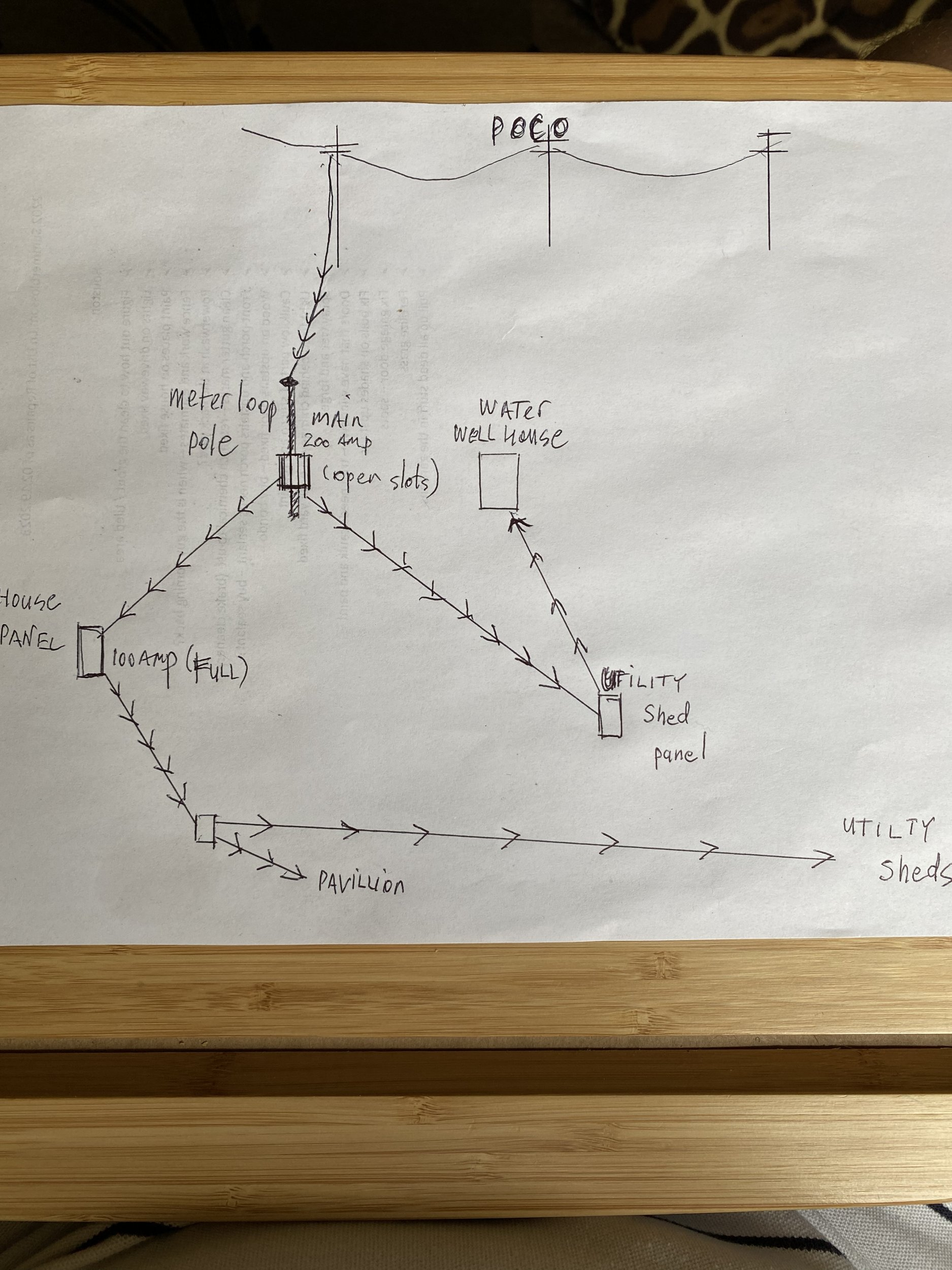

Hello to all,
Ive enclosed a drawing of the electrical panels and flow of power.
the main 200 amp Siemens panel was just installed. Has a 40amp CB that controls water well & shed. This panel has open slots The 100amp Sq D Homeline panel on house has no slots. This panel also feeds 2 other low bandwidth areas
Based on the drawing, what make & model would you install and where? I know some SP’s require a free/open CB, while others do not. Pls let me know if you have any questions. Thank you.

Here’s drawing

Surge suppressors are best installed closest to the Service Entrance ground rod for maximum effectiveness.
So the new Siemens 200 Amp panel in your diagram should be installed as the Service Entrance panel. The first location between you and the Utility power with a disconnecting means.

short answer is at the main service. longer answer involves understanding what a SPD is and how it works.
A SPD is a crowbar circuit (it shorts the bus to ground when the voltage exceeds a specific voltage). The location of the SPD in the Circuit is influenced by many variables such as point of surge injection and location of sensitive components.
To illustrate this concept lets use your example. in most cases you are trying to protect from surge injections in the utility line and are trying to protect your sensitive in the house (after the main), in this case the best location is the service entrance.
simple right? but if your sensitive equipment are all located in your water well house and the line going from the main to that location is exposed to a source of surge injection (think lightning) then it would be better to install the SPD in the well house.
surges are caused by current injected into the system which react with the resistance of the wiring (Voltage = I(current) X Resistance) to create a high voltage (much higher than the devices can handle) which the SPD shorts to ground but if the surge injection point is on the same side of the SPD connection as the sensitive device it is of little help. so in this case it is best to install the SPD in both locations the house main and the well house.

yes, the point of entry of the power is usually the best place, for surges impacting the power lines. but as noted, we have lots of errant lightening issues, so all bets are of w lightening. if a nearby errant hit makes it to the house, then anything there is not protected bc it did not come either thru the main entry point or the homes 100amp panel.
Since the 100amp house panel is full, I would have to look at both an external solution AND one that did not depend on a dedicated c-breaker...they are all taken. The 200amp main panel has both the breaker space and the inside room.

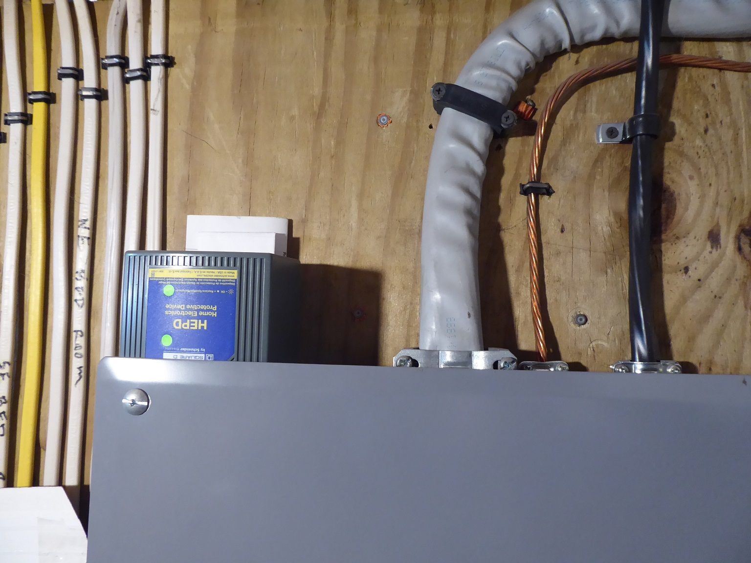

We live at the end of a very long dead ended line and lightning surges were a common problem. I put in an external Square-D surge protector. No trouble since. Mounted it in a knock-out at the top of the 200 Amp panel near the line entry and connected it to the top of the busses with short wires.
gg
I have installed 2 HEPD80's about 5-6 yrs ago and they are both doing well, still w 2 green lights
