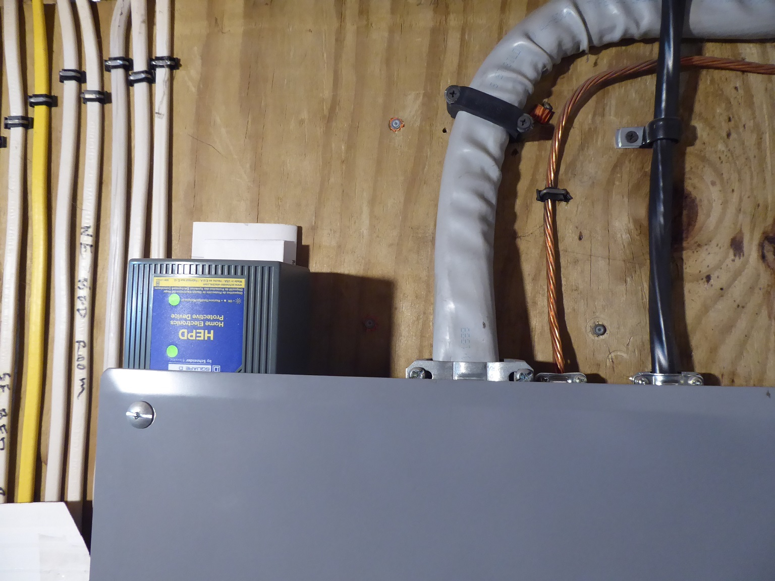

I have installed 2 HEPD80's about 5-6 yrs ago and they are both doing well, still w 2 green lights
