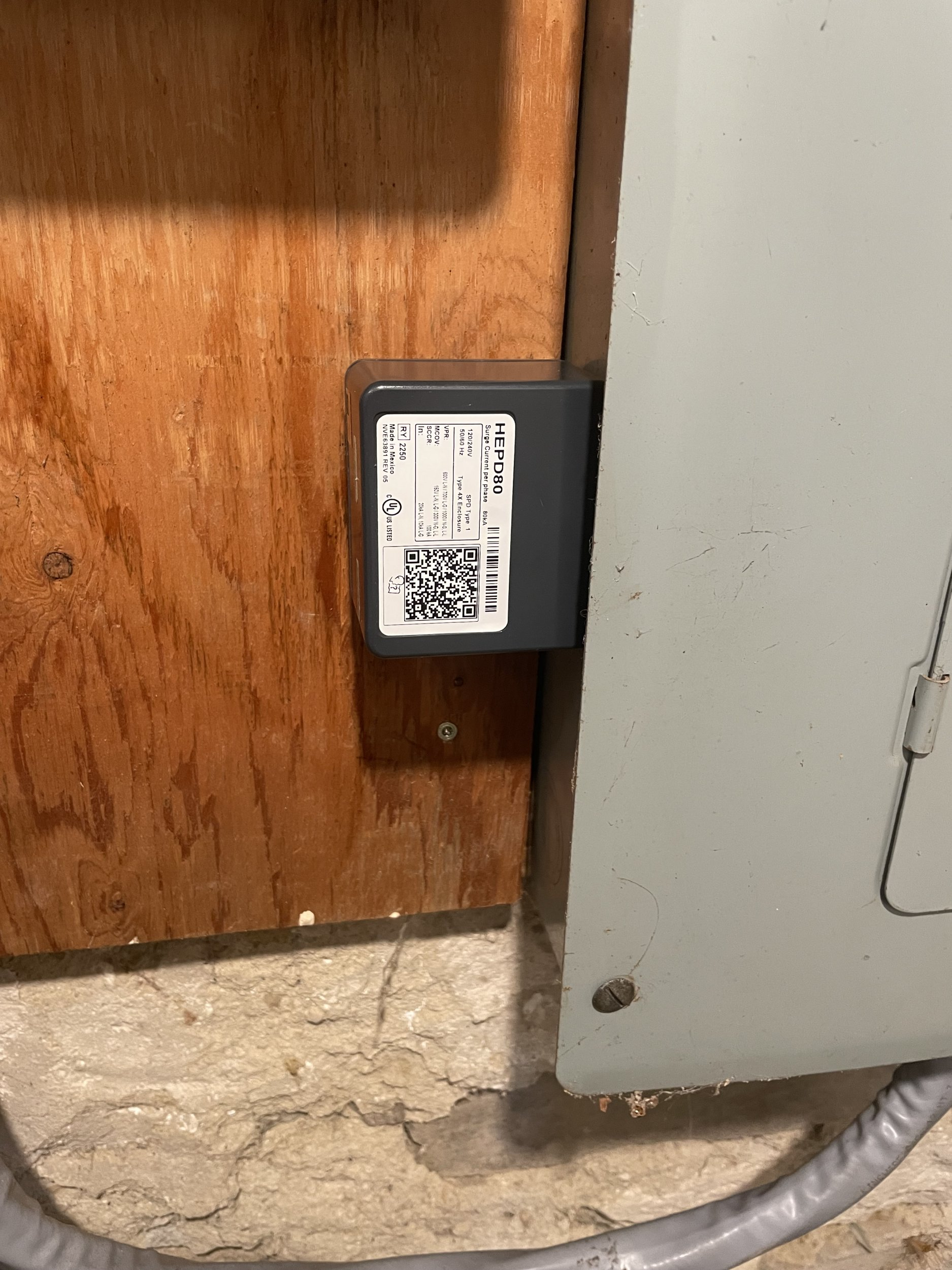

/ Surge protector woes #25
Installed today a Square D surge whole house surge protector
